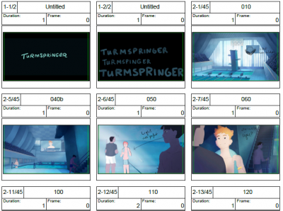

In the Project View (thumbnail) there is the big grey bar around it.

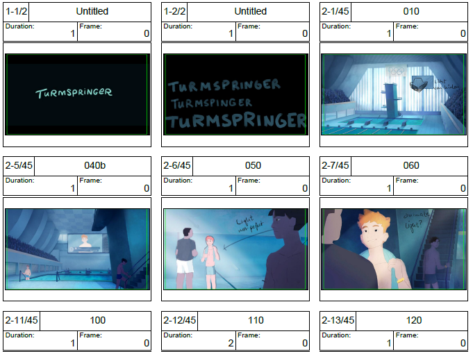

And when I publish it as a pdf there's all the project information which I don't need - just the pictures without writing would be perfect.
Does anyone have a solution for this or do I just have to live with it?
Thumbnail view for color script

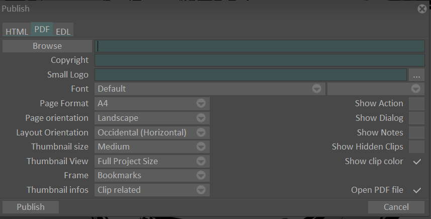

Hello Oscar,
When you publish your Storyboard / Colorscript, you just have to uncheck :
• Show Actions
• Show Dialog
In this case you should have only the thumbnails (pictures).

Re: Thumbnail view for color script
It's already quite useful! Thank you.
Could I get rid of the text there still is somehow too? I don't need it but I can figure out how.
You're welcome
Actually, we can't publish only the thumbnails without any text and fields in TVPaint's Publish window.
