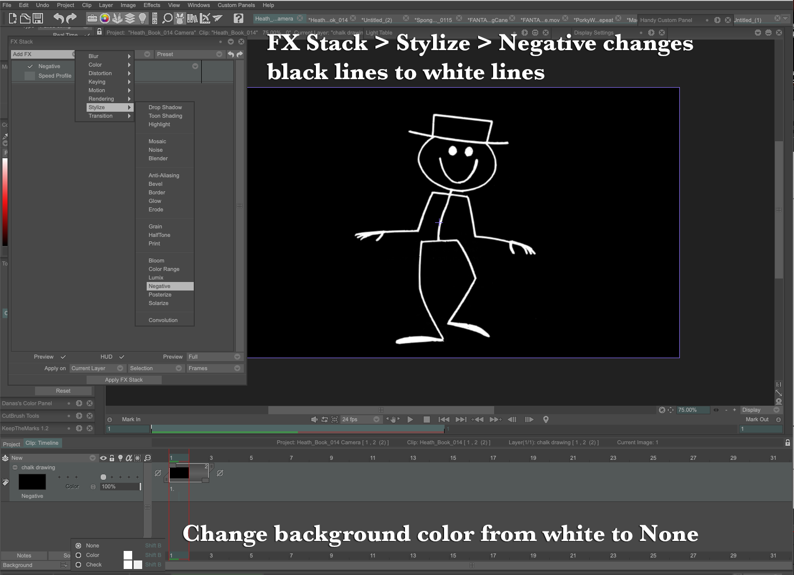

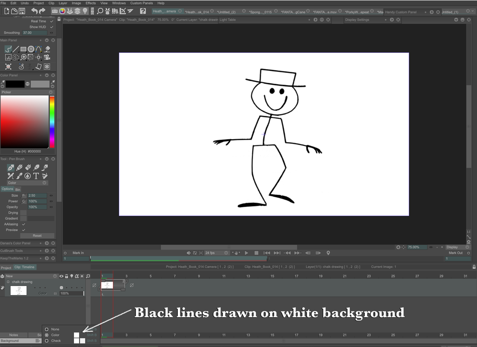

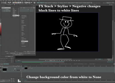

One other way you could do it is to have all your animation completed as black lines on white background.
Then change Background from white to None and from FX Stack use Stylize > Negative to change the black lines to white lines. (I would suggest you do this by duplicating your original layer of animation and applying the Stylize > Negative FX to the duplicate layer.)
