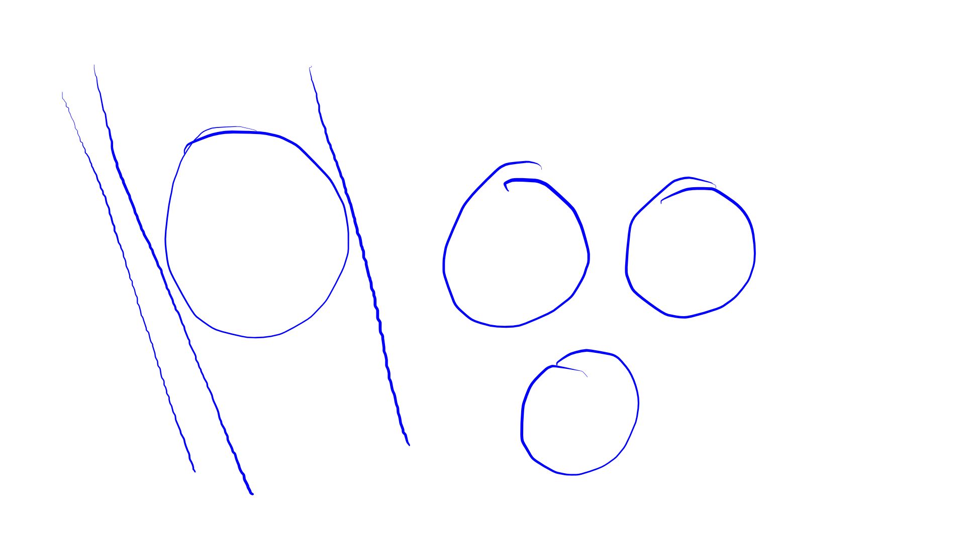

I'm trying to use TVPaint on an Ipad, by moving TVPaint from my MacBook Pro to the iPad, but TVPaint keeps crashing. These are the specs:
MacBook Pro: Memory 16GB, macOS Ventura
Ipad: Version 16.6, iPad Pro (12.9-inch)(4th generation)
TVPaint: 11.7.1-64 bits
I'm also getting those jagged lines when drawing. I've attached the image showing the jagged lines and the settings under the general tab.
Thank you for any help to solve these issues!
Robert

Are you using Sidecar ? I've had good results using Astropad Studio, to draw in TVPaint on my iPad Pro.

Thank you for your reply. Yes, I am using Sidecar. I'll have a try at Astropad Studio and report back.

I'm happy to report that AstroPad works for me! Thank you so much for your help. The only thing that I'm trying to find out, is how to turn off that "Pink" streak that follows the stroke of the apple pencil? It's slightly distracting. Do you have the same function? Is there a way to turn it off - I don't know if it's the Macbook Pro, iPad function, or a setting in AstroPad.

I've figured it out! I found how to access the settings in AstroPad and turned off the stroke to none.
