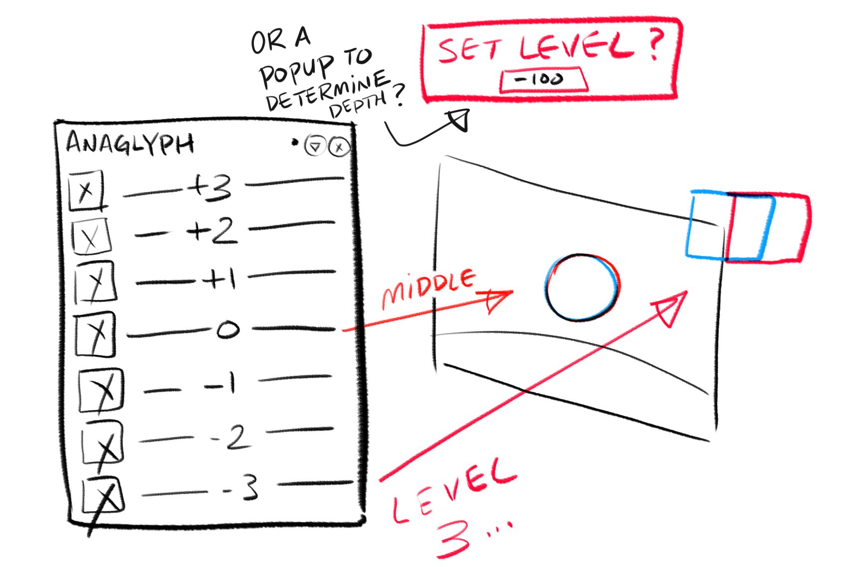

That would be amazing if you can help! Yeah, it would be nice to have a tool where you select part of an image with the lasso selection tool, press a toolbar button, and it give you a popup, asking a numeric value to send the artwork to in "space". -200 or +200... -10 or +10... and the image is placed on two separate layers using that offset, one in red, one in blue (cyan), with the layer on top set to multiply mode. Positive values would make the red or blue closer together or farther apart on the x axis. Something like the attached image:
They would be:
Red - rgb(255, 0, 0)
Blue - rgb(0, 0, 255)
Green - rgb (0, 255, 0)
Additionally you can do complimentary colors:
Cyan - rgb(0, 255, 255)
Yellow - rgb(255, 255, 0)
Magenta - rgb(255, 0, 255)

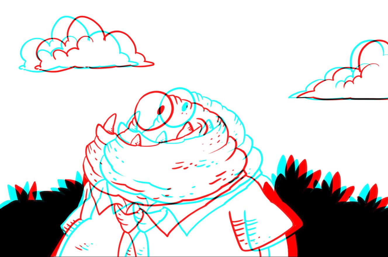

Here's one I did manually. It gets tough when you have to re-draw or erase portions of the drawings when things overlap. On the main character here I used the warp in the FX stack to bend the body of the creature outward in a slight sphere by moving several points in the center to the left on the top red drawing. Sort of works.. not very well. (Hey, I'm an amature at 3d conversion. Although I did once take a class from the legendary Ray Zone, rest in peace.) I can't imagine the amount of work Charles Barnard did on the Jim Woodring book to achieve what he did. It's an incredible achievement.

Your drawing works quite well for me. Using a warp effect on the object volume is something I never considered. It suggests to me that it might also be possible to tilt and skew between an object's red/cyan components and their white backgrounds in slightly different directions so as to permit a single object to appear to project or recede in Z space. Will have try that.
In my thinking, creating elements of a drawing on different layers (or pre-separating the objects in an existing drawing onto multi-layers (restoring their occluded parts) could make iterative tweaking of the 3D much easier in a script that automates the process... AND would definitely lend itself to multiframe animation where layers of the drawing move above/below each other or an individual object moves forward and/or back in the space.
