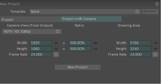

Unfortunatelly with the actual engine, all your Clips (different Timelines) have the same resolution. I advise you to create a project with camera with a lot of secured zone on your canvas (File > New Project... > New Project with Camera)
It will allow you to define a ratio bigger and reate camra movement. We think about the possibility to have multiple resolutions in a same project, but it will be in a new future version later.

I would suggest the same as Leo mentions above about creating projects with Camera View at standard output (1920 x 1080 or whatever you prefer) with extra border area (200% - 300%) so you have plenty of room to move the camera vertically or horizontally.
