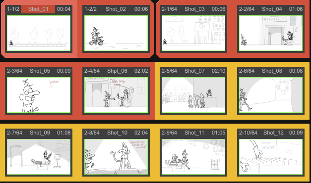

Is it possible to export every single clips in my "project" tab so they become separate TVPaint projects (and it would be even better if every project would be saved in de separate folder).
Screenshot 2024-03-04 at 08.14.37.png (73.22 KiB) Viewed 6989 times
For example: See this image. They are all called "shot 01", "shot 02" and so on. I would like to have these shot as a separate TVP file in a folder with the same name and it would be really helpful if this could be automated.

I created it using Clips To Projects in Handy Custom Panel.
What do you think?

Wow! this is exactly what I meant!
Thanks you so much!
