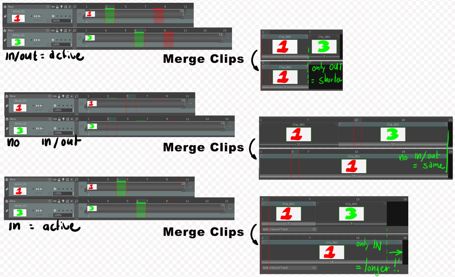

Namely it does work if you switch off the Mark-in/out of the first clip.
Then it will join both clips and display the correct pre-merge length
how ever...
a Mark-OUT on the first clip will cut off any of the merged clips following, resulting in the second cliplength disapearing from the timeline!
and a Mark-IN on the first clip will be ignored resulting in a merged clip that is longer then before the merge!

Peter Wassink wrote: 12 Jun 2024, 12:14 I agree this is wrong and could be considered a UX bug imho.
I think you may reasonably expect that when you merge two clips, the newly combined clip is going to be the same length as the two unmerged clips were together.
There is some logic to this ...though this behaviour is still unwanted and should be fixed.
how ever...
how ever...
