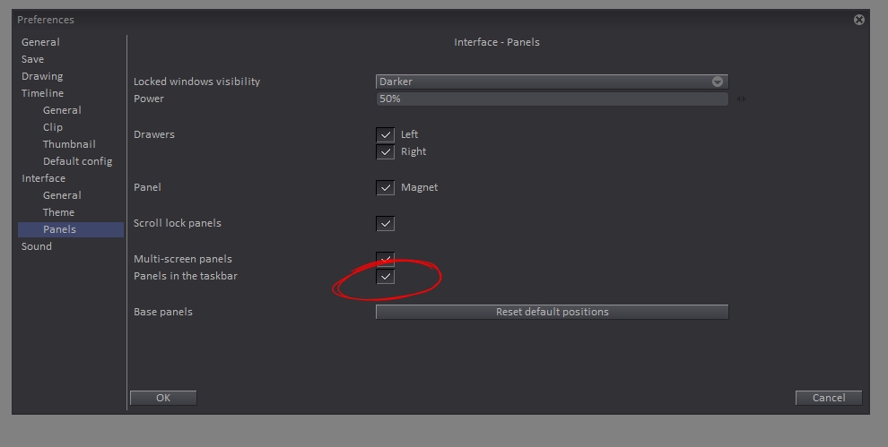

Peter Wassink wrote: 24 Jun 2024, 15:26 Unfortunately i can't test it because my V12 has lost its export panel(!? those floating panels are not yet bug free )
Sorry to butt in, but I wonder if you have tried this Peter regarding your missing panels. I have been able to retrieve my missing panels(sometimes they end up loading up behind other panels and take a while to locate) So I haven't needed this yet, but if you relaunch Tvpaint 12 with it enabled, you are able to tab through(on windows, not sure how it works on Mac) your panels like individual windows. Also they are all under the TvPaint icon in the tray and you can select each one individually.
Wow thanks, i'll switch that on, the first v12 build had this as standard and it was annoying in its own way, but if they stay within one taskbar tray i can live with it.
Those panels playing hide and seek the whole time is a main reason i don't like v12!
