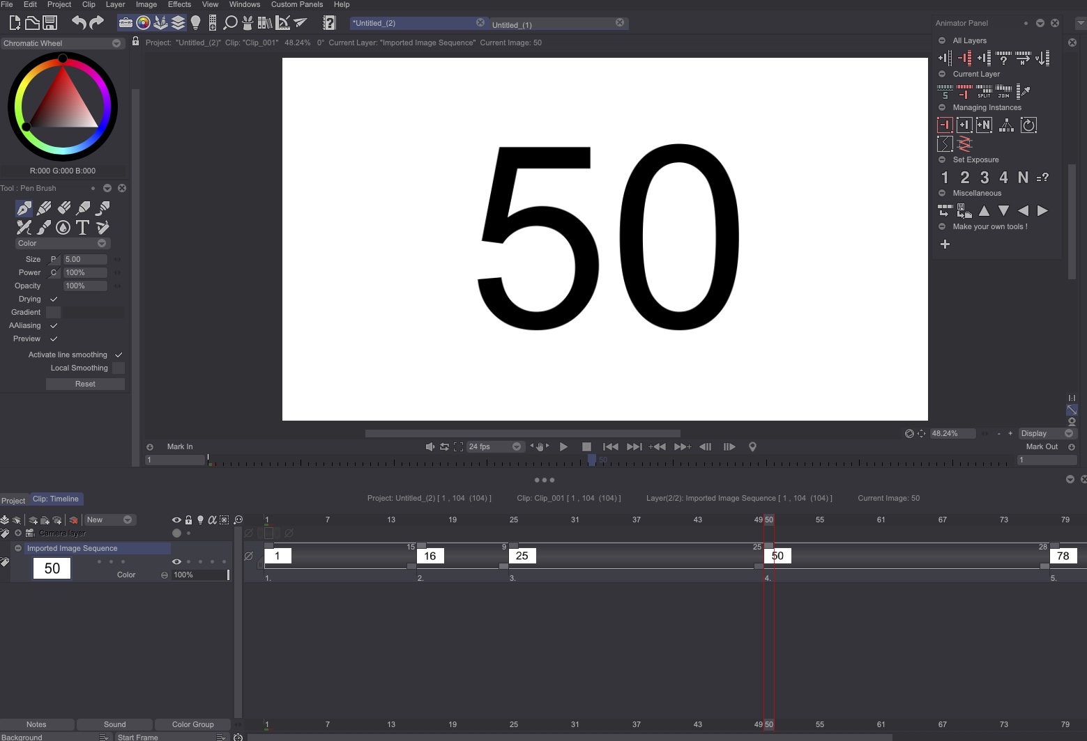

It is a useful script , but what would be even better is if TVPaint would import the image sequence with gaps in the numbering and place each image at the frame which corresponds to the image number, so you would not have to place each image at the correct frame manually
Screen Shot 2024-07-05 at 10.13.54 AM.jpg (71.42 KiB) Viewed 41496 times
Therefore, in an image sequence numbered 0001 , 0016, 0025, 0050 , 0078, 0144, 0178, 0275, 0442 the script would import those numbered image files into TVPaint and place them at the correct frame numbers on the timeline: 1, 16, 25, 50, 78, 144, 275, 442.
Right now the only way to do that if I'm importing an image sequence with gaps in the numbering (say importing a sequence of key drawings made in another animation program such as Clip Studio Paint) is to export from the other program as a .MOV file (RGBA mode, with transparent alpha channel) , then import the .MOV file into TVPaint. This places each image at it's assigned frame number.

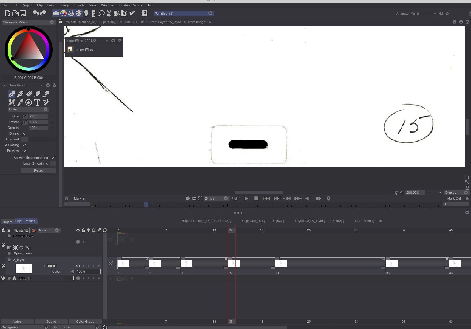

This is good to know it is working for you now. I did not notice in the screenshot in your original post that there was the extra . before the number.
Anyway, I still think that the same function of Hironori Takagi's custom panel should be built-in to TVPaint when importing an image sequence which has gaps in the numbering sequence,
so this Feature Request is a good one:
When importing an image sequence with gaps in the numbering (for example A_001.jpg , A_005.jpg , A_009.jpg , A_015.jpg , A_021.jpg, A_035.jpg, A_043.jpg, etc.) TVPaint should place the imported images on the same layer in the timeline and place each image at the corresponding frame on the timeline.
