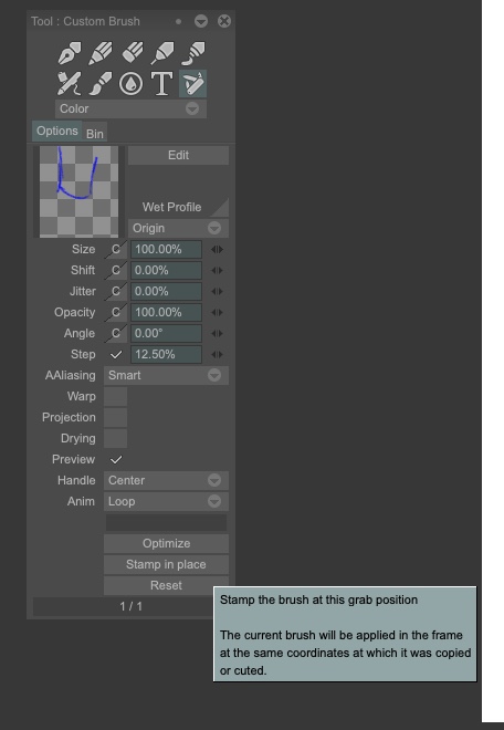

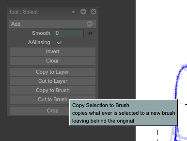

This would be a good feature , but in the meantime you can Select and Copy to Brush . You could select part of an image on a previous (or following) frame , then Copy to Brush, then Stamp in Place to place it in the exact same place or freehand stamp the copied image wherever you want it placed in another frame.

NOTE to TVPaint Developers about the Tool Tip for 'Stamp In Place' : it would read better in English if it said "The current brush will be applied to the frame at the same coordinates at which it was copied." Delete the words "or cuted" ... this is one of those odd English language usages, because past tense of cut is cut , not cutted. (and not "cuted")
