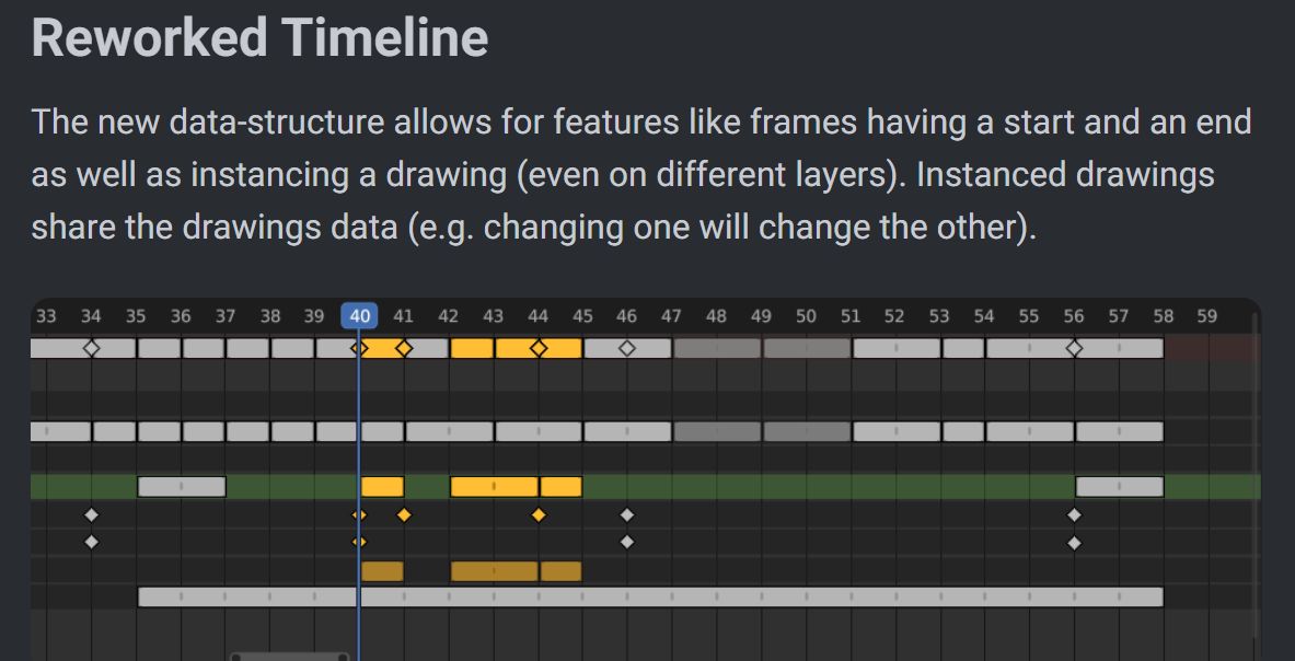

An option or switch to make linked instances (instances with he same name) "hot linked"
meaning that once an instance is named and copied it you change one of these all other with the same name will change too. and you might have to think about signifying the difference between a custom named instance and a dynamic named one ( the tiny dot after the name 001. is a bit subtle)
Even blender grease pencil has this now.
