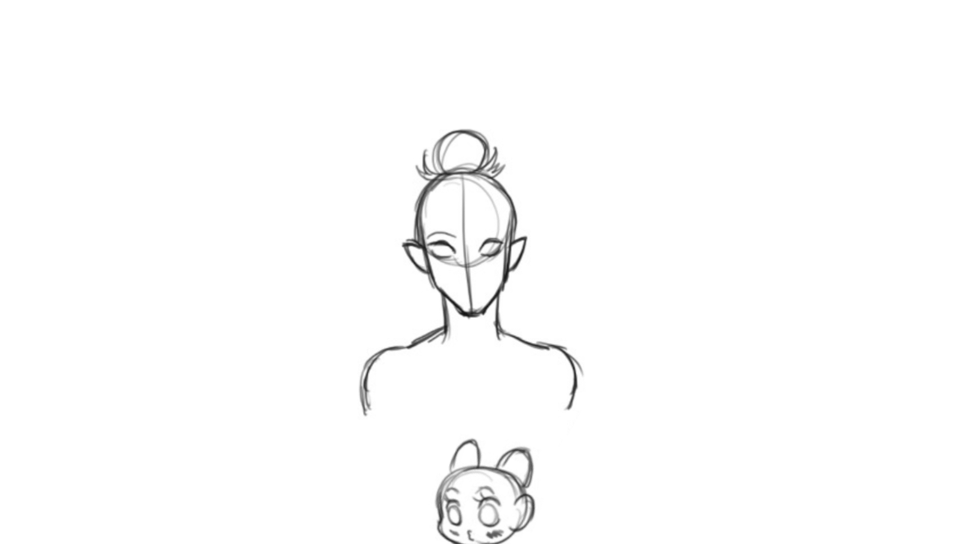

HELLO!
TV Paint NOVICE HERE! Complete newb!
Okay I feel like I may have to do this in AE but I'm curious can I make these chibi heads rotate around this guy in the center in TVP?
Or is this something I will have to figure out in After Effects?
The idea is to make the chibi heads rotate like a Ferris wheel.
