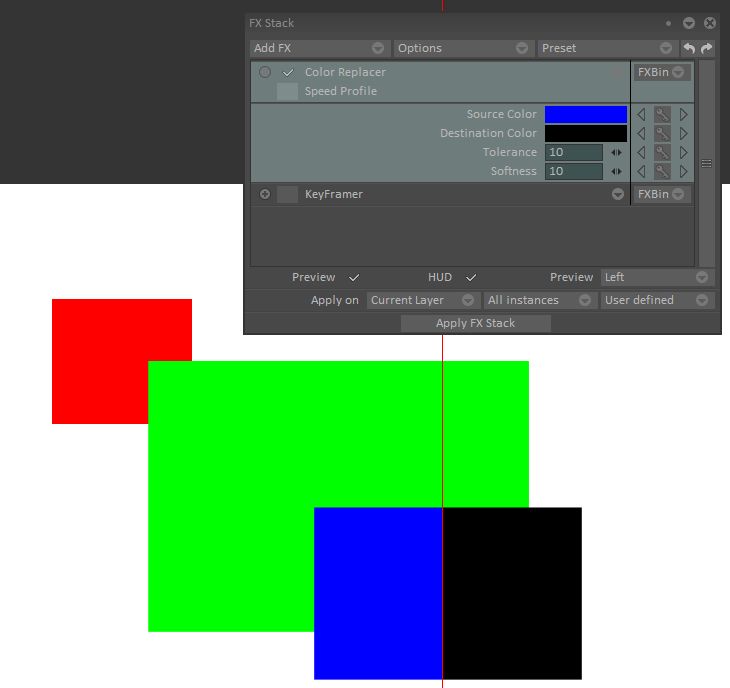

why not use the FXstack>replace color?
in this image you see in the splitscreen preview what it does to blue...

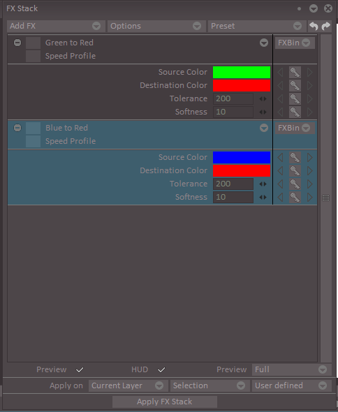

Reacting a bit late but I ended up going this route :)
I created bins of the color replacer for each color, and assigned them to buttons. A bit tedious, as each option had to account for several colors, but it worked in the end:
Screenshot 2025-05-28 220608.png (27.47 KiB) Viewed 6576 times
I just end up checking the color I'm interested in and apply to the frames that need it.
