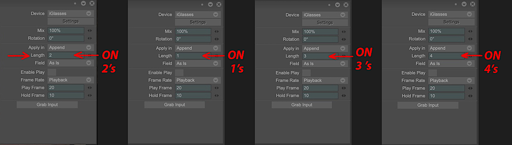

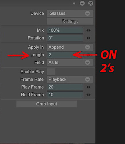

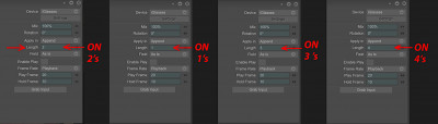

Let's say you have captured a sequence of 23 drawings , ON TWOS: 1, 3, 5, 7, 9, 11, 13, 15, 17, 19, 21, 23 , 25, 27, 29, 31, 33, 35, 37, 39, 41, 43, 45 . To capture the drawings like this, we have set the Video Input to Append , Length = 2 , which means each time you click on Grab Input it will capture the drawing on the downshooter and expose it on the TVPaint timeline for 2 frames. (by the way, if all the drawings are not ON TWOS, if you have some drawings exposed ON ONES within that group of drawings, just switch Append, Length = 1 whenever you are capturing those drawings that should be ON ONES, or if you have some drawings ON THREES or ON FOURS , change the Append, Length = 3 or = 4 )

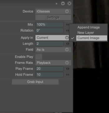

click on image to see it larger Now , let's say you play it back and you realize you need to make fixes on drawings 17 , 19, and 33 . Back to the drawing board, make your fixes on 17, 19, 33 , then place drawing 17 on the downshooter , advance to frame 17 on the TVPaint timeline and change the Video Input setting to Apply In = Current Image .
Capture drawing 17 by clicking Grab Input. (you can also assign function Grab Input to a keyboard shortcut in the shortcuts preferences). This will replace the previously captured image at 17. Now advance to frame 19 and repeat the same procedure . Then advance to frame 33 and repeat. You have now replaced the three previously captured drawings 17, 19, and 33 with your new 17, 19, and 23. As long as the position of your webcam , lights , and peg bar on the downshooter has not changed since you had previously captured the sequence of drawings, you will have seamlessly replaced the old images with the new images.
