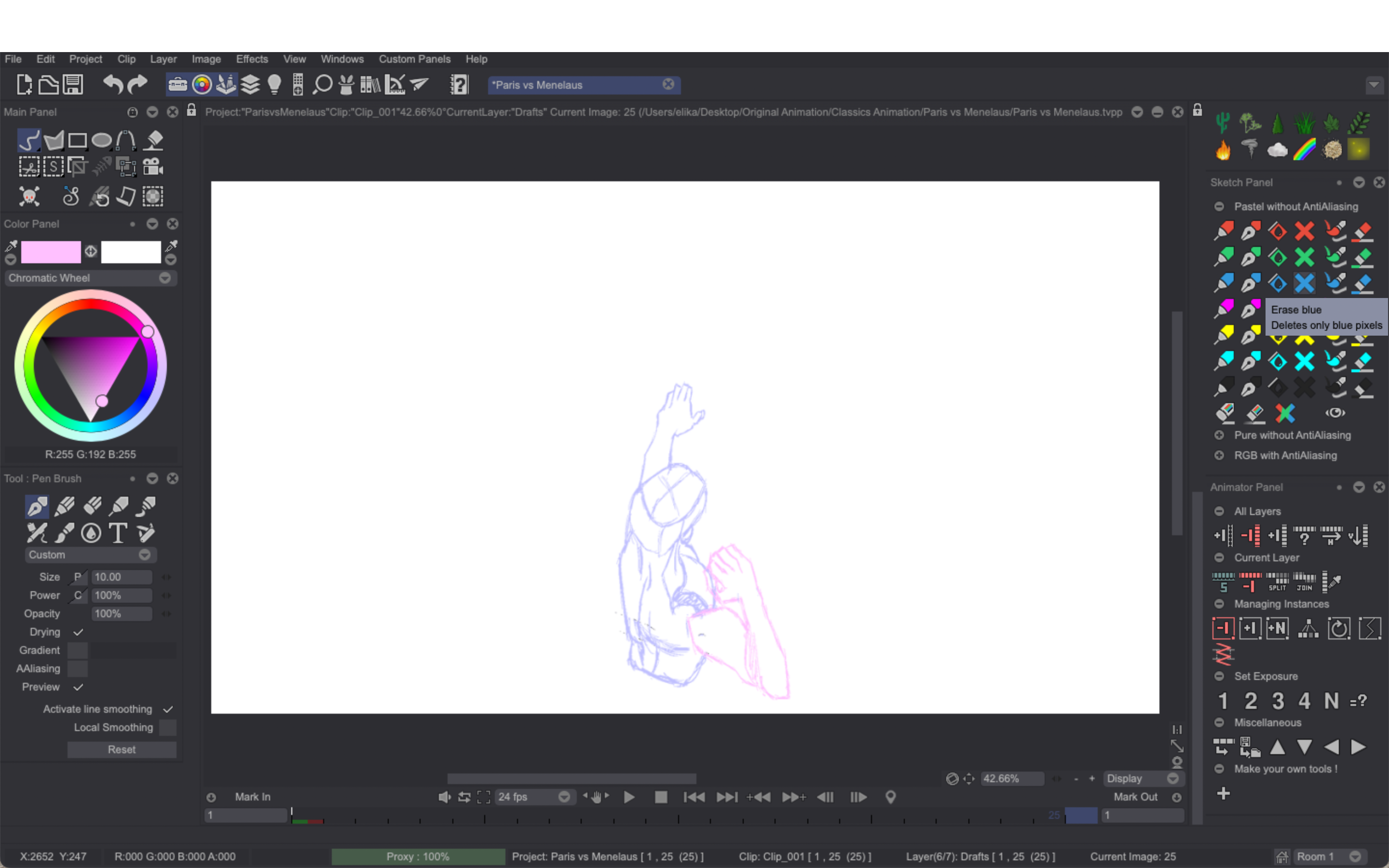

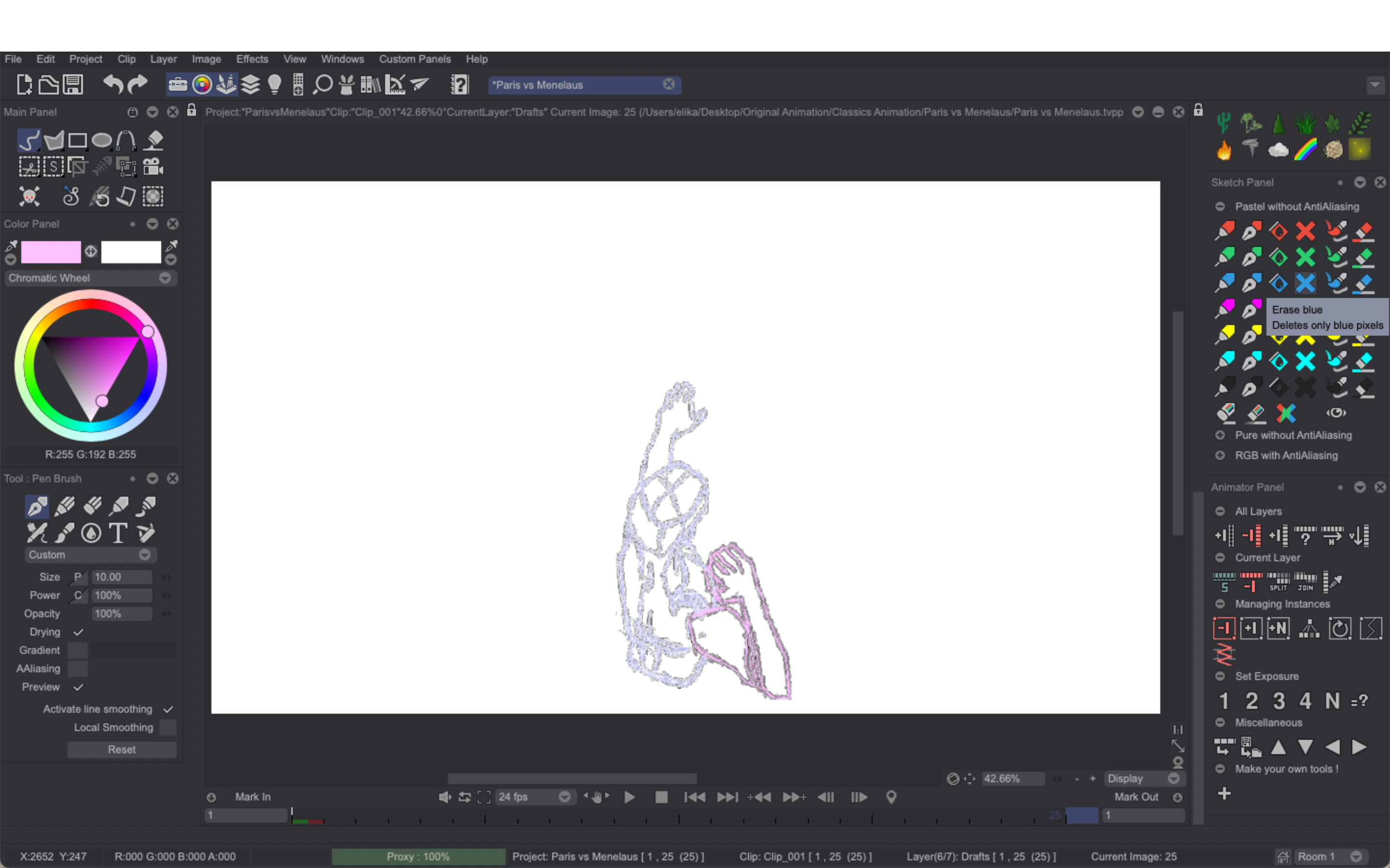

Hello, I’ve recently downloaded TVPaint this summer and have been figuring out how to use it. When I run into issues, I’m not sure if it’s me being a newbie or the software but either I would like to find out and improve!
Right now I’m encountering a problem where when I click any of the ‘erase’ a specific colour buttons in the sketch panel all my lines end up having a black outline and look very pixelated. I’ve attached a before and after of me only pressing the erase button for the dark blue colour to show the problem. This is the only layer visible in the project. If someone can please explain why this happens and how to avoid this problem that would be great! I just want to erase all the dark blue lines and keep the pink ones.
Before I click the button to erase the dark blue lines: After I click it: Details about what I’m using:

Confirmed in 11: if you use pure and pastel intermittently, like drawing pastel and eraseing same colour pure, some strange effects may appen when erasing, so far that something completely erased shows up again in grey.

Hello tvpaint_newbie28824,tvpaint_newbie28824 wrote: ↑03 Sep 2024, 16:09 Right now I’m encountering a problem where when I click any of the ‘erase’ a specific colour buttons in the sketch panel all my lines end up having a black outline and look very pixelated. I’ve attached a before and after of me only pressing the erase button for the dark blue colour to show the problem. This is the only layer visible in the project. If someone can please explain why this happens and how to avoid this problem that would be great! I just want to erase all the dark blue lines and keep the pink ones.
The "Erase" buttons in the Sketch Panel works only with specific colors (RGB : red, green, blue and black / Pastel : red, green, blue, magenta, yellow, cyan and black). These colors have specific "ID", so if you try to erase a color with not the same "ID", it will erase a part of the color with some "glitch". If you need to use the ERASE buttons from the Sketch Panel, you need to use the colors PenBrush from the Sketch Panel which use the right colors "ID".
