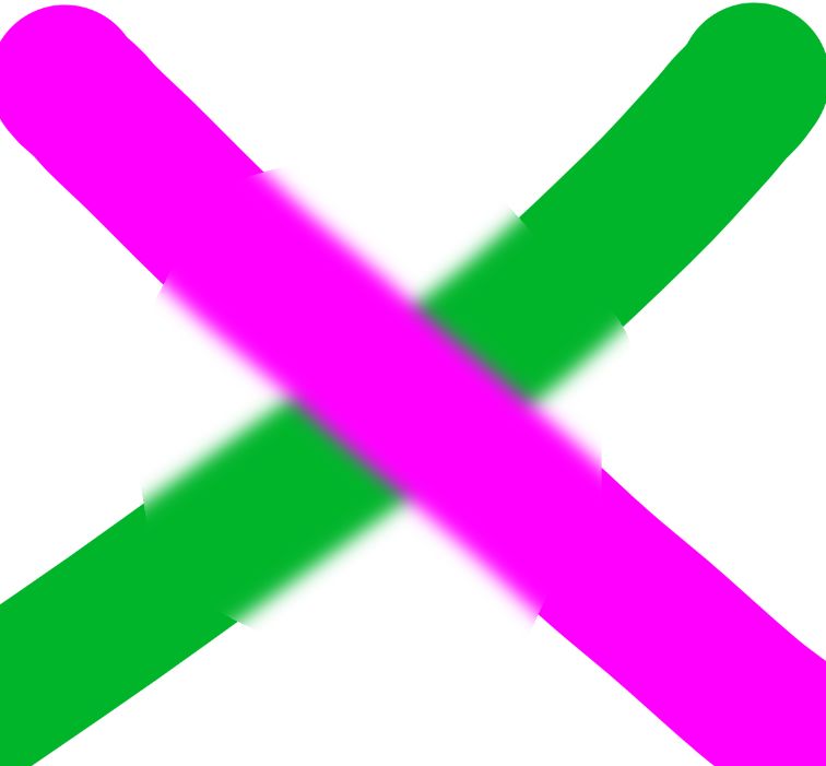

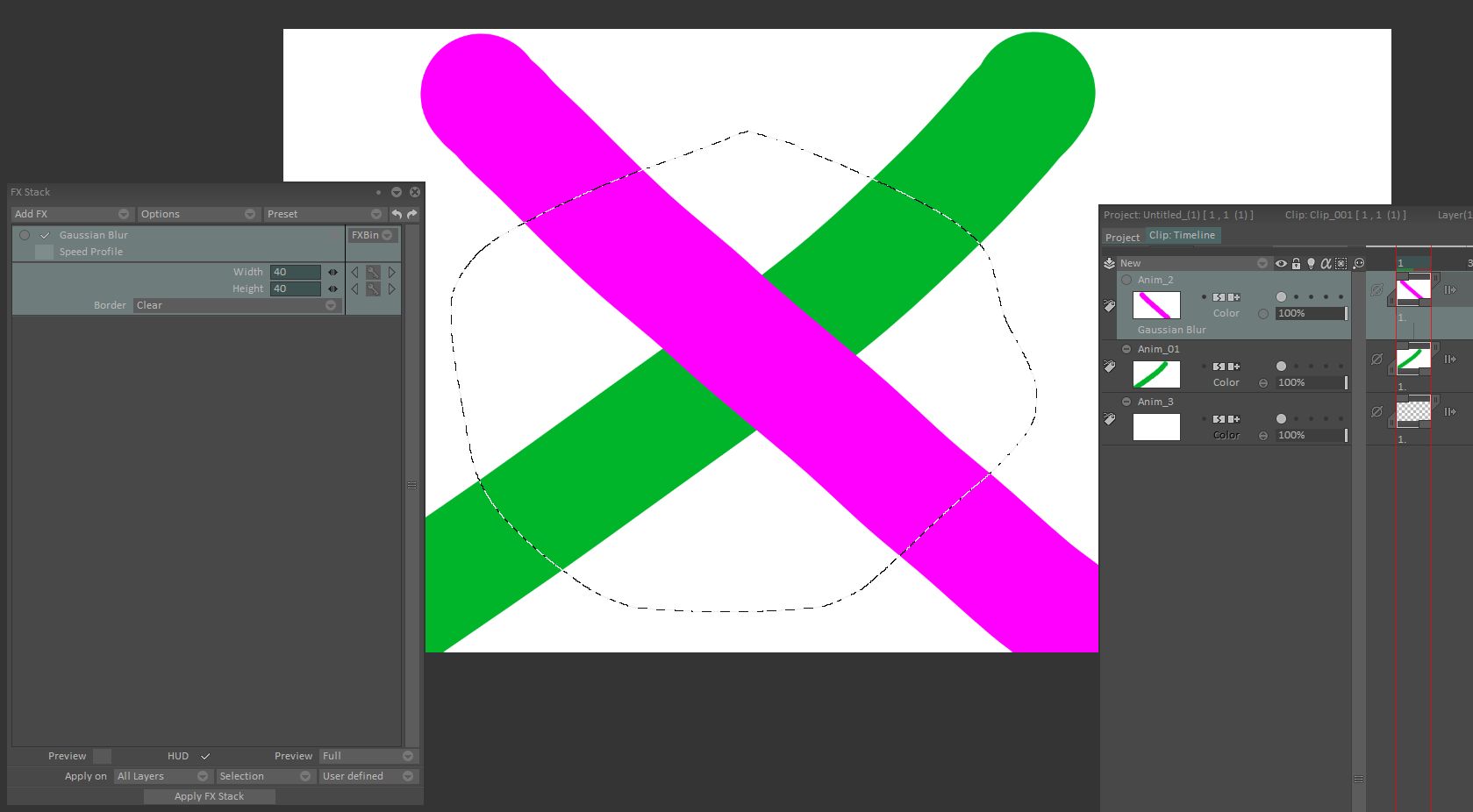

i wanted to test if my assumption was correct.
by applying a blur on all layers while a selection is active...
but it did not work as expected! one of the lines in this example simply vanished !?
weird bug
in the preview only the active layer gets a preview of the effect
if you are on the purple layer and apply the purple line disappears
and if you are on the green layer when you apply the green layer disappears...
however if you `then click anywhere the layer pops back up with both layers showing and with the applied FX on both layers in the selection area only.
note FXstack is set to 'apply on all layers'
the active layer disappears after applying...
bug not 1.jpg (21.05 KiB) Viewed 29799 times
but clicking anywhere brings it back with the added FX
bug not.jpg (21.29 KiB) Viewed 29799 times

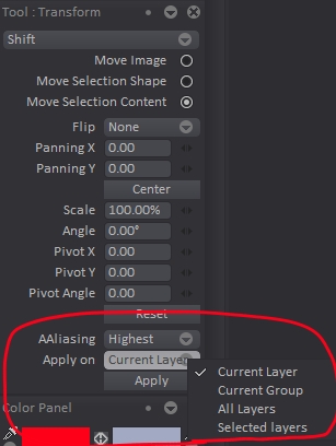

I wonder if Max is maybe thinking along the lines of this being useful as an option for affecting layers like the drop down menu in the transform tools? Right now there is Current Layer/Current Group/All Layers/Selected layers, but perhaps a DISPLAY would be useful as a quick way to select the layers that are enabled rather than having to select them all/add them to color groups etc. I could see this being really useful in theory, although all the apply on multiple layer tools are a bit cumbersome to use at times due to lack of being able to see a preview of multiple layers. Hoping we get the ability to see all the layers affected in the preview in the life of v12!

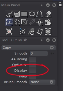

Hi Max, maybe I am misunderstanding, but regarding cut/copythe brush, isn't that what the "Display" option already does if you have it toggled?
Also just for clarity in regards to what I said above, I was thinking outside the FX stack when you use the transform/perspective tool, in this menu.

Oh, I think I understand now. There actually is a way to do what I think you are looking for, you just have to use display on/off under the cut brush tool before using select. You probably already know this and are just looking for the option for these settings in the select menu, but just in case.
All of the options under cutbrush tools; copy/cut, display, keep etc. will affect the Shortcut > Shape Select > Copy to CustomBrush, which you can use with a selection from the select tool.
For example
Go to cut brush, and make sure DISPLAY IS ON
Use the freehand select tool > make a selection
Use the shortcut(you will have to assign a key to it) > Shape Select > Copy to CustomBrush
This will act just like the cut/copy brush but with the select tool, and viola you have your brush cut with the DISPLAY and your selection, rather than just the single layer, and you can use the select tool to precisely grab what you want.
