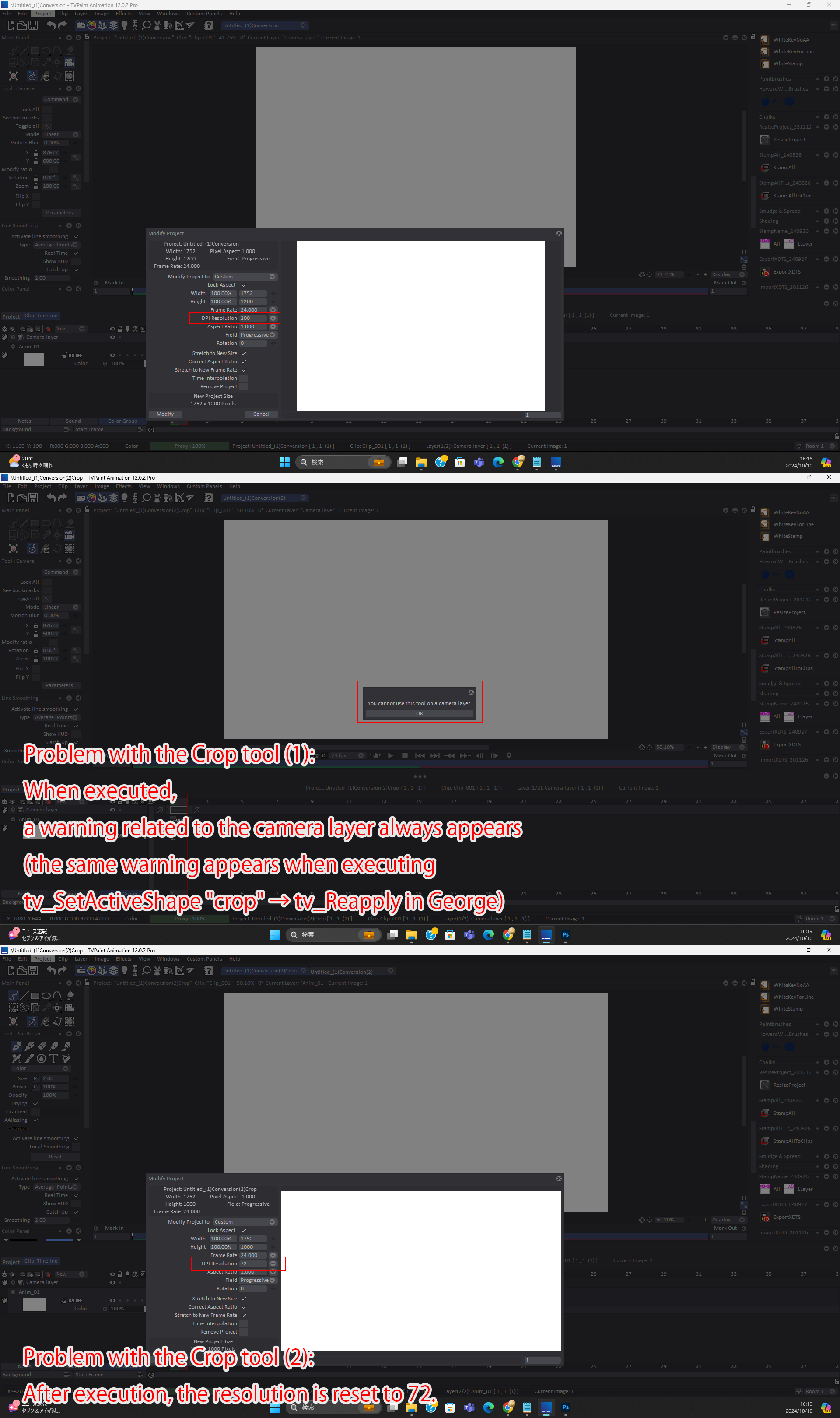

I'd like to report two issues I found while working on adapting an existing custom panel to TVPaint12.
(1)
When executed, a warning related to the camera layer always appears in Ver.12
(the same warning appears when executing tv_SetActiveShape "crop" → tv_Reapply in George)
(2)
After execution, the resolution is reset to 72.
This also happens with TVPaint 11.7.x
I look forward to a resolution.

Hello Hironori Takagi,
We managed to reproduce your issues, our devs will look at it as soon as possible [TVPA-3726] and [TVPA-3727]
