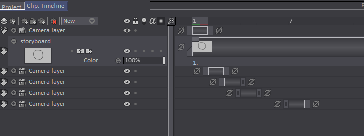

In addition, when merging clips, the camera layers in each clip are added and cannot be removed, resulting in a stack of useless layers that cannot be deleted (Please see screenshot).
Camera Layer issues
Camera Layer issues
- tvPaintCameraLayers.png (30.66 KiB) Viewed 21505 times

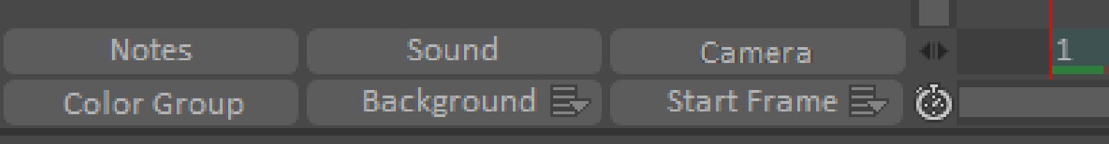

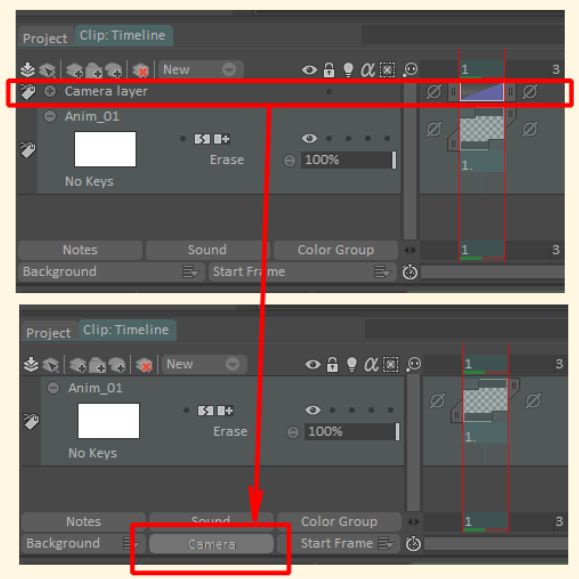

simply add a button to hide it, just like you can the Notes and the audio layers, its the most simple and logic solution.
ah wait i already did a mock-up... a year ago
It should not be in the way like it is now, especially since the camera control is not quite working yet. (Team did you try to work with the thing yourself?)
And also ...as you point out... in the majority of cases you will not need it.

We will see what we can do about this, thank you for your feedback Satchiken! Please know that you can delete any Camera layer by clicking on its "Skull" icon when not selected:
