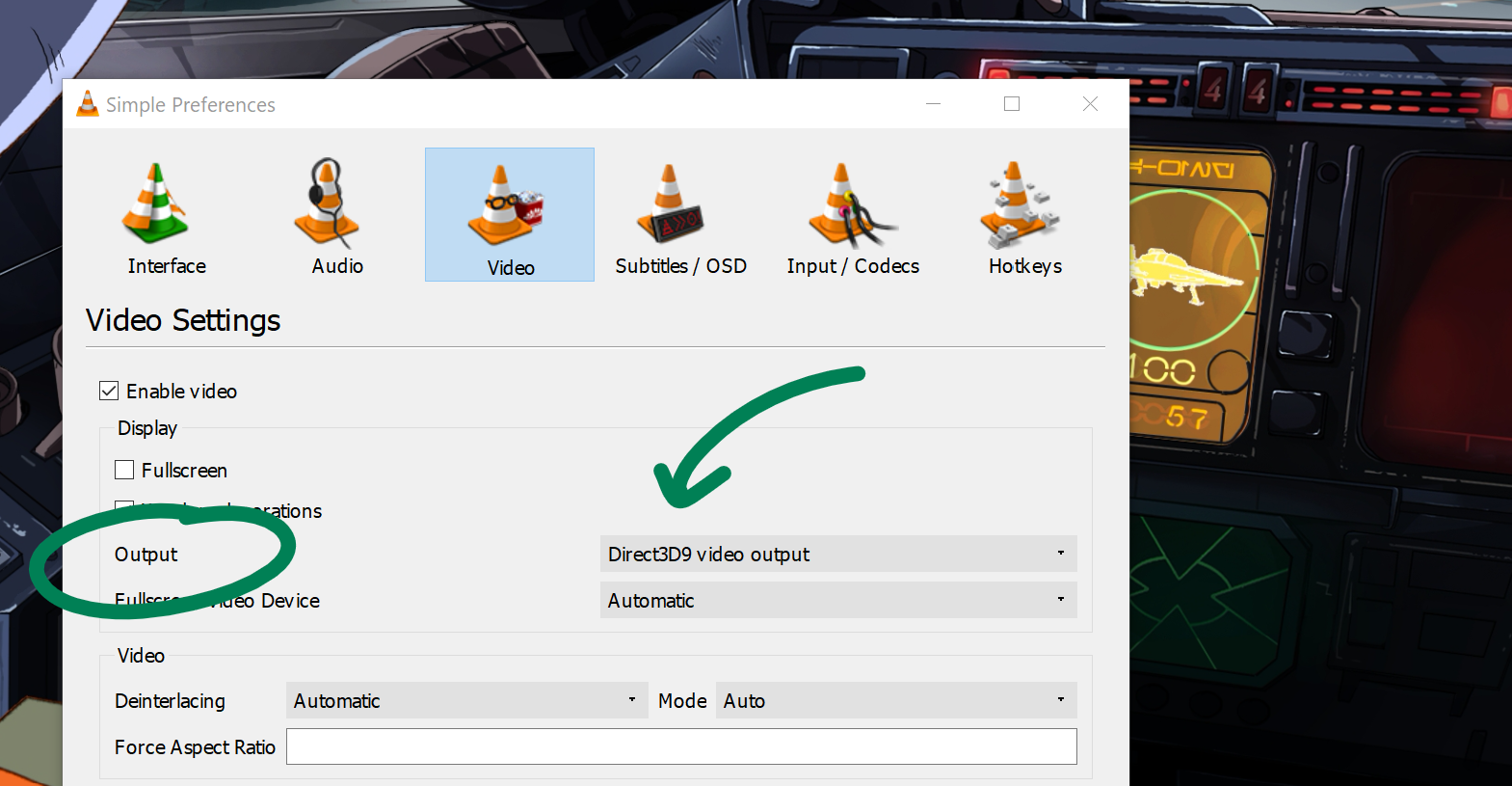

I exported you project and the same problem happens when playing it with VLC (also on Windows exporting from TVPaint Pro 11), but it seems to be fine either by
- playing it with mpv or Keyframe MP
- changing the "ouput" in VLC to Direct3D9 (this is where I read about the solution). You have to restart VLC to see its effect.
- or taking a snapshot from VLC and the snapshot looks fine, even though the video is not
