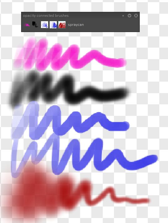

Posts: 4517
Re: Pressure Sensitivity Opacity Brush Connections
i went back to v11 (still prefer that version!)
i made an animated brush of 256 steps and connected the animation to pressure
an important option is the alpha diff blendmode which neatly blends the opacitys together...
That drawing mode was custom made to fit the painterly animation style of Hisko Hulsing
opacity brush.jpg (42.25 KiB) Viewed 8969 times
opacity brushes panel.tvpx
(1.26 MiB) Downloaded 294 times

Thanks Peter. Ya, I forgot in the original post to mention alpha diff, and only mentioned alpha max. It does works better for a single stroke build up, but then there is a problem with building up multi strokes over top of each other, especially of different colors. For lack of a better term, the strokes "eat" into one another and the way faint falloff works, and your original strokes are kind of absorbed into the original instead of painted over. I should have waited until I had time to post visual tests to support my original post, but have been strapped for time, I will try to do so asap. So, I still feel like the opacity connection would be ideal, but appreciate the help.
