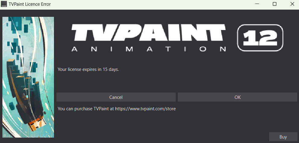

Initially TVPaint was working as it should, but then when attempting to open a project I was presented with the following "TVPaint Licence Error":
If I click either 'Ok' or 'Cancel', the prompt disappears but TVPaint does not start; nothing happens after that point.
