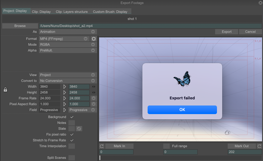

Hi everyone,
I'm currently using TVPaint 11 Pro, trying to export a project and I'm not sure why it's failing. Perhaps the file is too big?
If you need more info to help me out I'm happy to share.
Thanks

MP4 doesn't support alpha. Set mode to RGB and try again.

slowtiger wrote: 28 Nov 2024, 21:47 MP4 doesn't support alpha. Set mode to RGB and try again.
I had tried that and it didn't work. My best guess is that the issue is the resolution as I'm only having issues with MP4, it's exporting in the other formats.

It seems that 3840x2448pixel is the upper limit.
