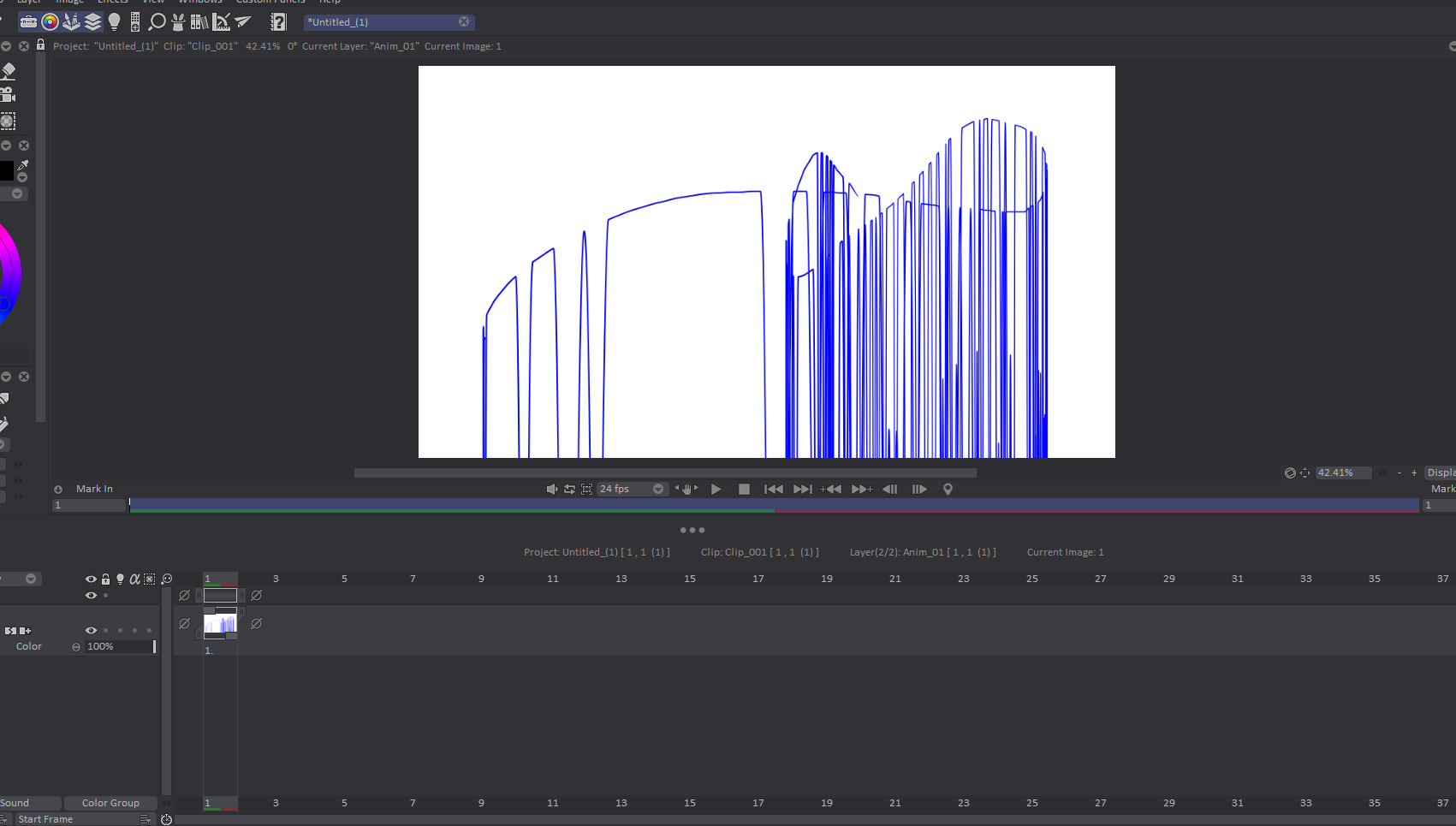

TVpaint 12 line skewing for dual monitors?
Post by Markxu »
As picture blow shows, whenever I use the dual monitors, the lines will all skewed to one side. I wonder if there's a fix for this. I am using tvpaint 12.
I am using win 11 for reference. wacom cintiq pro 22, 32gb ram

Re: TVpaint 12 line skewing for dual monitors?
Post by Hironori Takagi »
There have been previous logs on this issue.
I hope it helps.
https://forum.tvpaint.com/viewtopic.php?p=132400
Posts: 1143
Hello, settings the drawing mode to Wintab and ticking the Subpixel option in the TVPaint Preferences should mitigate the issue.
It should also be completely fixed by the upcoming 12.0.3 patch.

Hironori Takagi wrote: 16 Jan 2025, 05:12 There have been previous logs on this issue.
I hope it helps.
Wow! Hironori Takagi you are a life saver!!! Thanks a million!
Post by hellofilms »
Dean wrote: 16 Jan 2025, 08:26 Hello, settings the drawing mode to Wintab and ticking the Subpixel option in the TVPaint Preferences should mitigate the issue.
Looking so much to be able to use the pen as wintab and being able to use the right-click option. I can´t fint the Subpixel option to tick in the preferences. Where could it be?
Posts: 1143
On Windows, it is in the General tab of the Preferences panel in TVPaint 11 and in the Drawing section of the Preferences in TVPaint 12.
hellofilms
Posts: 168
Joined: 12 Nov 2012, 12:13
Location: Älvkarleby, Sweden
Dean wrote: 22 Jan 2025, 08:21 On Windows, it is in the General tab of the Preferences panel in TVPaint 11 and in the Drawing section of the Preferences in TVPaint 12.
I found it, YOu had to choose the wintab option to get that subpixel option. The line is now fine but I can right-click to get that meny up. Will that be changed with the path or will it not be able to work? I think it worked on windows 10.
Posts: 1143
This issue was already present on Win10 for some tablets, however the upcoming update 12.0.3 should help with this
hellofilms
Posts: 168
Glad to see the fix in 12.0.3. Seems to work perfect so far.
