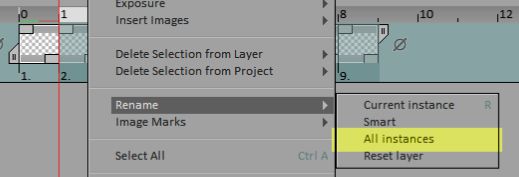

why not be consistent and have a rename option like instances have?:
rename all.jpg (12.96 KiB) Viewed 2648 times

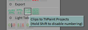

I think Lukas Sketchpanel command :
Should be integrated into the project view and also as a command in the clip menu
