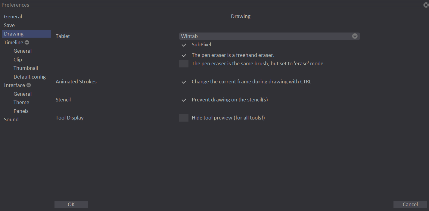

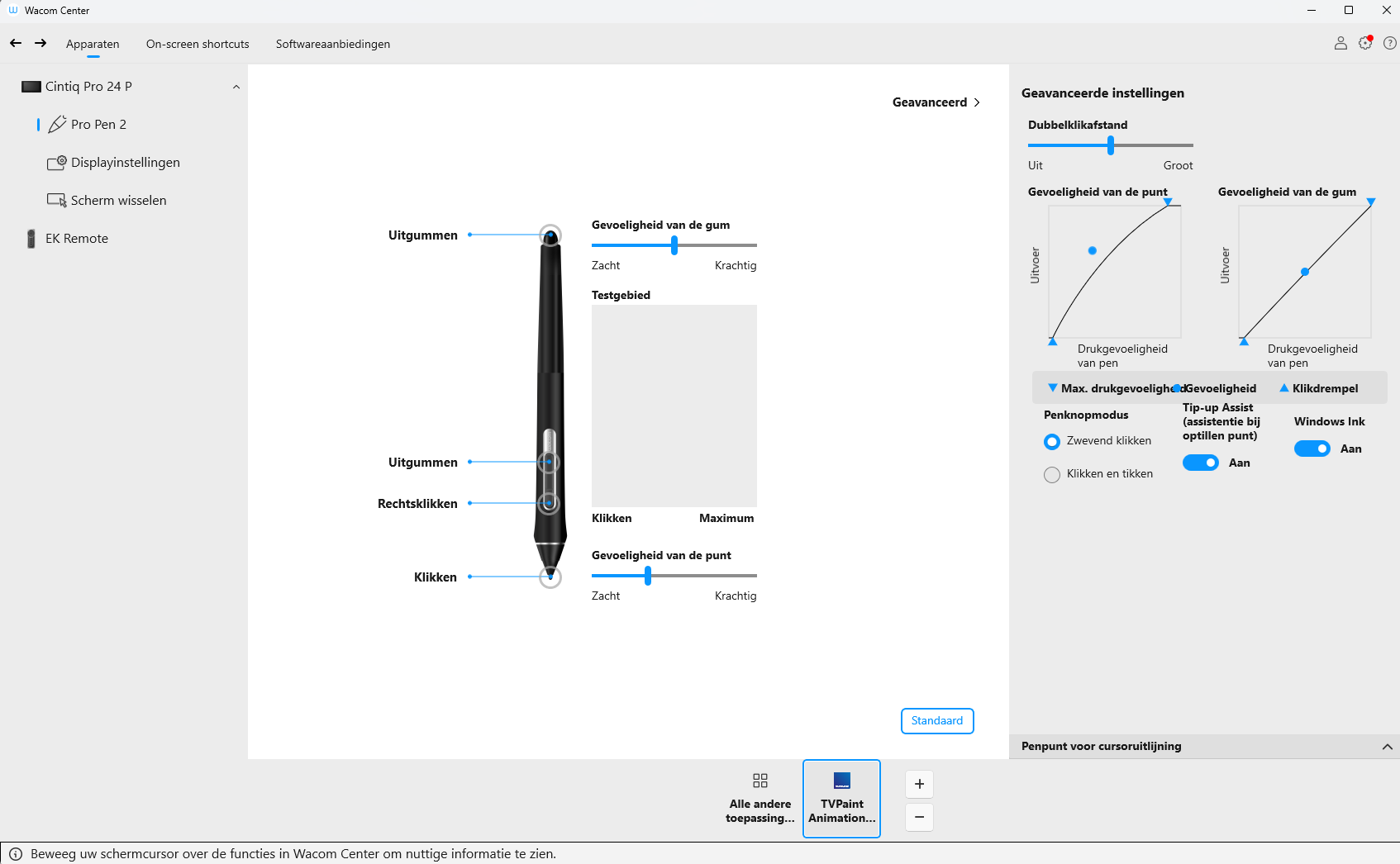

Here are my pen settings for wacom and tvpaint. Drivers are up to date
Tvpaint settings
Tvpaint settings
Pen settings TVP.png (36.8 KiB) Viewed 592 times
Wacom settings
Wacom settings
Pen settings 1.png (92.81 KiB) Viewed 592 times

Hello, I see that your TVPaint is using Wintab but Ink is still enabled in your Wacom driver, could you see if disabling it helps please?
