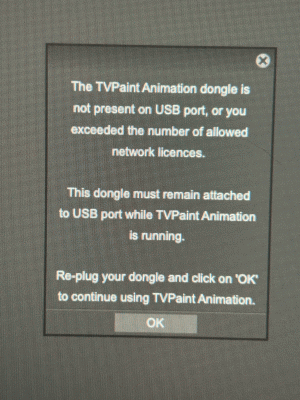

My TVP license was very recently changed from a dongled to a dongleless license.
I just tried opening a TVP file I had worked on a couple of days ago and am getting this notice about the dongle not being present and to replug in the dongle, but my version is dongleless.
How do I fix this?
Thanks!

Hello BruceM, it seems that the default version of TVPaint that opens files from your file explorer is still the dongle-based one.
It is preferable that you keep only the latest one you installed.

Oops! Yes, that seems to have been the issue.
Thanks Dean!
