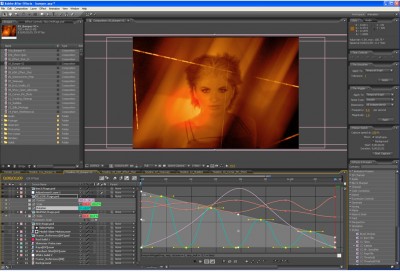

Would it be difficult to build a graph editor for the motion keyframer?
Now sometimes it's impossible to control the curve of the motion (for instance when I want to move horizontaly only with different speeds and motioncurves).
I attached a screengrab from after effects, which has a very good graph editor with bezier-curves.

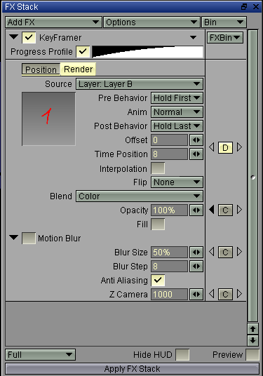

an other way imho would consist to have a new KeyFramable variable,
"Time Position" linked to the "Offset" value in the Render Tab, (... see pict.)
note: the [C] button (Create Key) should be ghosted when the Source is set on
FX Stack, Current Layer, Spare, or Paper.
