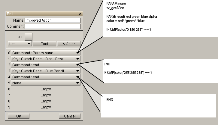

I included a examble of an action where I make decisions regarding the a pen color and rund anither bins action.
in the first Commandslot I typed this script
Code: Select all
PARAM none
tv_getAPen
PARSE result red green blue alpha
color = red" "green" "blue
IF CMP(color,"255 2 0") == 1
it gets the A pen color and if the color is Blue
It selects the Black Pencil action from the Sketch Panel
Then a Have a New piece of scripting
Code: Select all
END
IF CMP(color,"255 255 255") == 1
that ends the If statement
and then checks that if the color is black it runs the next command
which is the blue pencil action from the sketch panel
the last command is a "END" that finish the IF conditionals tests
I think this would improve the use of TVP and scripting alot
And make it a easier to disribute script among computers/users you export your Custom Bin and the scripts would be Included. Then you also could type in your script directly without leaving TVPaint.
and and you would have access to all the keystrokes throug your scripting
