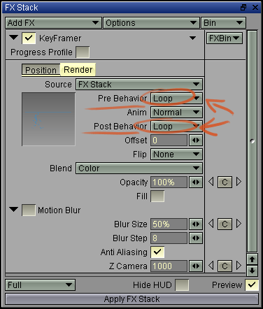

hmmm, could you post a screen-grab of your timeline window to help us to see what could be wrong ?
possibly a KF source's pre- and post-behavior settings (try to set them to Loop, see pict.),
but it could be something else...?

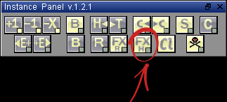

here it is :
it's the new FX H button in the Instance-Panel v1.2.1 (H for Heads)
uncompress, put the FXonHeads.grg file in your own george folder,
then "load a new toolbar..." as previously explained.
Instance-Panel_v.1.2.1.zip
(35.94 KiB) Downloaded 1512 times

The FXH button works, but on the fx-level. I think this is what it is supposed to do.
But for panning a walkcycle on twos by creating an animated fx-layer (one key with long exposure) refering to a source (the walkcycle layer on twos)
we would need the FXH butten working on the keys of the source.
Is that possible?
