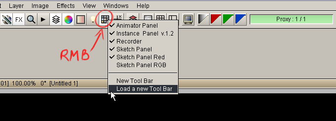

we have 2 different ways to load a new Custom Panel in tvpa :
(NB: Custom Panel appellation is equal to Custom Bar, or Tool Bar)
- from the main toolbar, right-click on the Custom Panel button (red-surrounded on the pic.),
and choose "Load a New Tool Bar" from the drop-down menu (see pic.),
then browse and pick the .bin file you have previously unzipped, then "OK" .
- from an already open Custom Panel, Right-Click anywhere in an empty place,
and go to "All Panels/Load a New Tool Bar", then browse and pick the .bin file ...
> lesson_18 from the manual.pdf for more about Custom Panel management,
and, here to ask solutions for any trouble you will run across.
