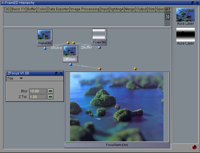

sinon il y a bien l'effet Zfocus (IO-Labs plugin),
mais aucune idée si oui ou non encore dispo...
comme tu peux le voir sur cette image (à droite)
ça date des années Aura2.x 8)

oui, compatible 8.5.9! 8) (avec de toutes petite restrictions,
comme par ex., on ne peut pas appliquer un effet uniquement sur
les Heads des Instances, l'effet sera appliqué sur chaque frame.)

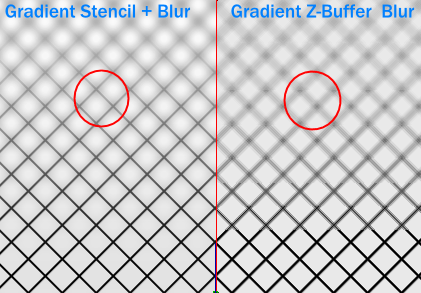

you can also do it with the FXstack:
create a mask (a gradient to transparent)
and apply a blur with the mask switched on

well, it does more or less the job, but it's not exactly the same result:
ZFocus is sensibly performing a progressive blur value, according to Z value,
when the stencil is working as a fade,
a 50%-fade between pixels with blur=0 and pixels with blur=14 is not equivalent to pixels blured at 7 ...
but I agree, mostly your stencil way, (as hervé's other alternative) could be used for a rather satisfied result.

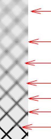

but it should be one without these obvious steps... :P
yeap, I noticed that,
I suspect the IO-Lab's Blur to accept only entire values (not decimals), so we can see "steps", or "gradations",
because between blur=0 and blur=1, we should have continuously blur=0.1, 0.2, 0.3, ... etc...
btw, I still have a lot of fun when playing with my beloved old ZDeform,
getting so quickly some fancy chaotic/organic univers ! :)

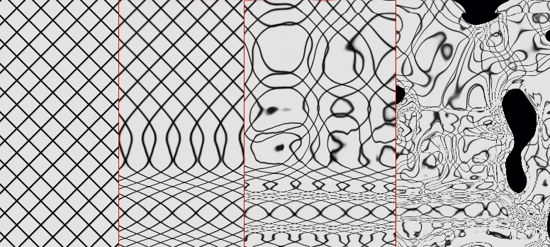

Tantalus wrote:c'est drôle!
did you get this with a b/w animation layer that is used for the displacement?
a 45° tilted black-on-white grid as source, and the Z-Blured still picture above as Z buffer,
with 3 times (cumulative) apply, ... could be keyframed, of course.
