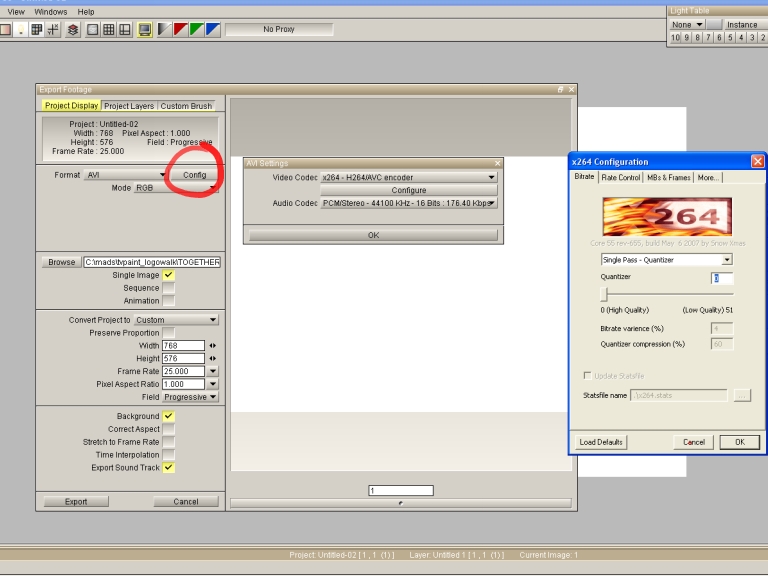

Thats interesting I have had the same problem with Adobe After Effects
I think its something to do with the Codec of the AVI You are exporting from TVPAint
Im using the x264 codec I just imported it into Premiere and it look ok but the colors ere off but im onle using black and white so its not a problem for me
divX or the Xvid codec looked better.
I dont know if you have these codecs installed?
which codec are you using
-mads
-mads
