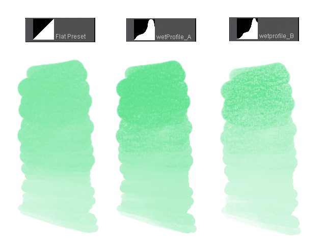

Re: watercolor and artwork
Thanks for sharing, and thanks for the detailed comments,
the upper layer (multiplied old paper) does the job very well, the final image looks very "trad. natural media",
About your custom waterbrush and your settings, I would optimize the brush to get rid of the empty space around it,
and I would set the Shift setting to none (or 0%), as Shift doesn't work in Alpha/Alpha max mode.
(it surely doesn't change anything here, but I use to avoid any useless item, since it doesn't hurt, and it could enhance perfomance particularily with old computer)
also, you can make a brush variation by teaking a bit the wet profile,
(to increase the paper texture in the "shading" third layer f.i.),
you can see the wet effect on the pict. below, same stroke repeated 3 times with != profiles.
What does the wet button do exactly?
I can see more texture, but it also appears lighter in the 3d example.
Could you please upload the optimized brush with the A profile and the B profile (and shift on 0%) with the same icon?
I don't have much time to play around with it anymore, and I don't exactly understand the working of the wet profile.
