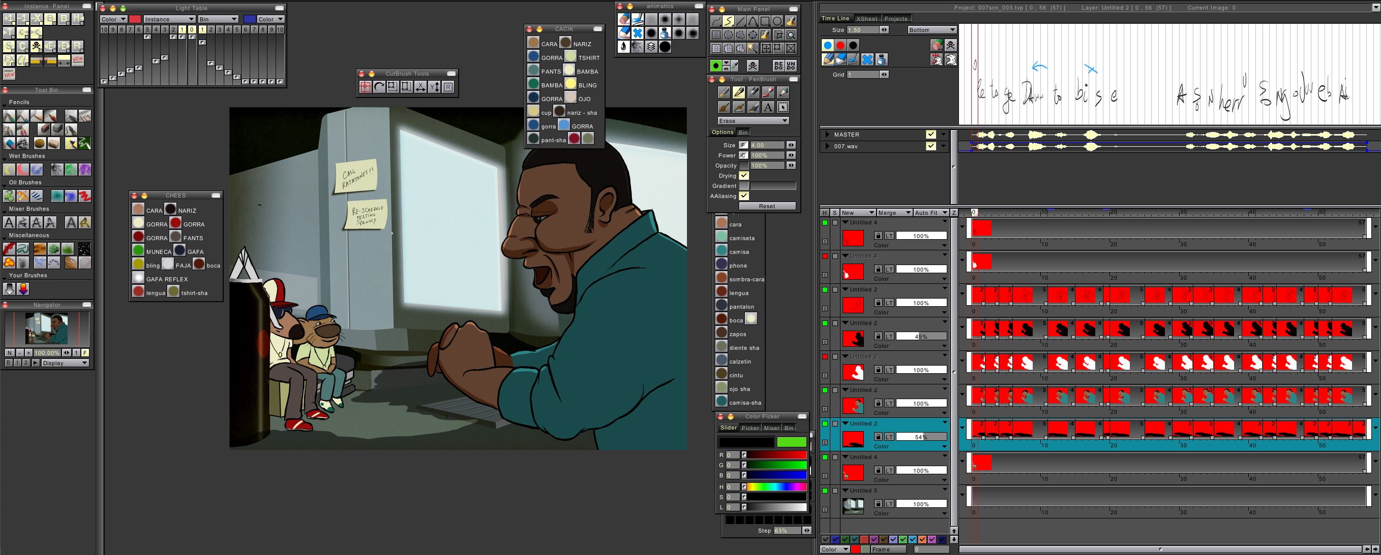

When you lip-synced, did you use the Time Line Notes section?
Re: New 1 min Animation
Yes. I find it very useful when scrubbing the audio but the notes never play at synch when I play them on top of the movie.
They work fine as a reference to make the key poses i think.
Staying in sync with the picture depends so much on finding a way to keep the playbackspeed as close to real time as possible. This is why I would like to see a real time indicator like NLEs have -- somewhere on the preview panel there should be a little window showing the number of frames per second being previewed at any given instance.
I have setup my room #2 just for sync notations. Here, the layer panel is stretched across all my screens and the preview window is kept in the center, just above the layers and quite small. Furthermore I keep the Preview Quality Custom Panel close to the playback controls. Also I keep the Preview Settings panel close to the Preview window. In other words I make it as easy as possible to switch between dropping the picture playback quality when I need to concentrate on the accuracy of sound and vice versa when I then draw to the annotations in room #1. I also often have Preview set to Proxy.
But when scrubbing I never seem to have problems with sync either but to be absolutely sure of this I often render my project to my NLE and playback there to see if sound is truly in sync to picture.
