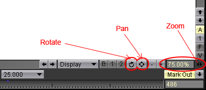

I probably didn't make it clear. In the keyboard shortcut configuration I can find the commands for panning, rotating and zooming only in one direction or set increments. What I would like to to do is assign commands from buttons on the workspace window onto the pen buttons, please see 'TVP_NavButtons.png' attachment.

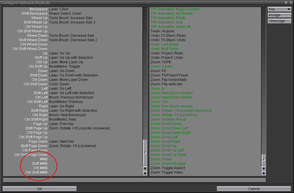

Also in the keyboard shortcut config there seems to be a middle mouse button keystroke but no right mouse button keystroke, see 'KeyboardShortCuts.png' attachment.

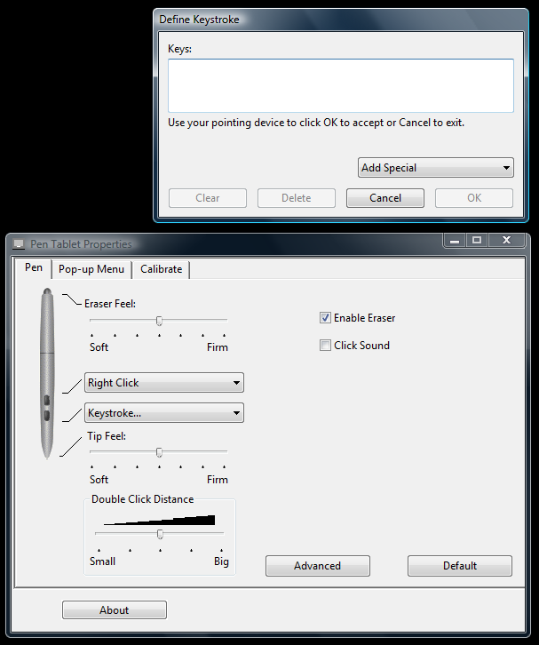

And last, on the tablet properties it does allow you to assign a modifier onto the pen button, ie 'ctl & alt' on the lower button, but does not seem to allow me to rotate my workspace when I use it with left click.
Just to let you know I'm using a tablet PC so when I draw the keyboard cannot be used.

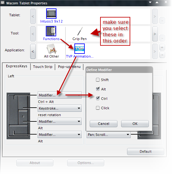

I seem to be able to assign CTRL + ALT to my Intuos3 modifier button and use it to rotate the project worktop.
EDIT: ah, sorry, didn't notice you was using a tablet and tablet control panel. In this case the limitation is in the Wacom driver, I believe. Because you are assigning one switch to a modifier, but using both switches at the same time (one is the tip of the pen being pressed down, and the other is the side switch). Which tablet do you have? Does it have any buttons on it while is slate mode?

Thanks for the reply malcooning. I'm using Fujitsu T5010 tablet pc and has buttons on the side but its only for Fujitsu applications I believe. I did test the modifiers in photoshop and it works fine. I'm not sure if it's TVP not happy with wacom driver or the other way round since the modifiers work in photoshop. The intuos3 driver doesn't work on the tablet pc. I guess I have to put up with it for now. Hope there will be a fix or an alternative.

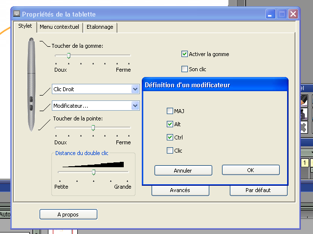

TerryWu wrote:And last, on the tablet properties it does allow you to assign a modifier onto the pen button, ie 'ctl & alt' on the lower button, but does not seem to allow me to rotate my workspace when I use it with left click.
I've tried to assign Crtl+Alt to the pen's lateral button, on my tablet-pc (lenovo X60T) it works fine, in tvpa, pressing the pen button + click and drag => rotate the canvas. Though I wouldn't change it, because the pen button to emulate the RMB is much more useful imo.
TerryWu wrote:I'm using Fujitsu T5010 tablet pc and has buttons on the side but its only for Fujitsu applications I believe. I did test the modifiers in photoshop and it works fine. I'm not sure if it's TVP not happy with wacom driver or the other way round since the modifiers work in photoshop.
well it seems it's not tvpa blamable, as it's working here (wacom driver v5.05-7). 8)
