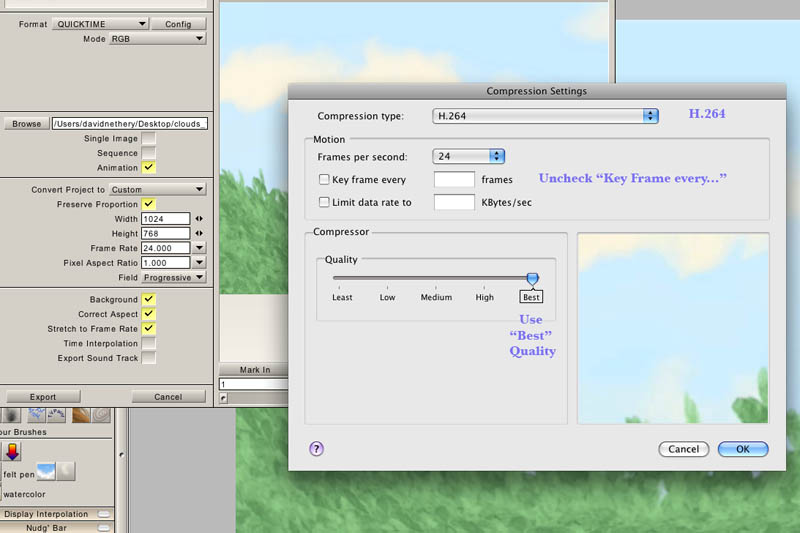

I will echo Peter on this: H.264 works fine for me if the "Key frame every ____ frames" box is unchecked . Check the QT export configuration.
QT export for H.264 must be set so that the box "Key frame every ____ frames" is Unchecked.
Set to "Best Quality" . I get very good quality H.264 exports using these settings.
export settings for quicktime h.264 from TVP
My main irritation is I wish that TVP would SAVE my last used export settings (H.264, 24fps , "Best" quality) instead of defaulting back to Animation codec, 30fps , key frame every 10 frames, "Medium" quality" . I almost always use H.264 at 24fps , so i wish that TVP would save that instead of me having to reset it to my desired export settings each time .
