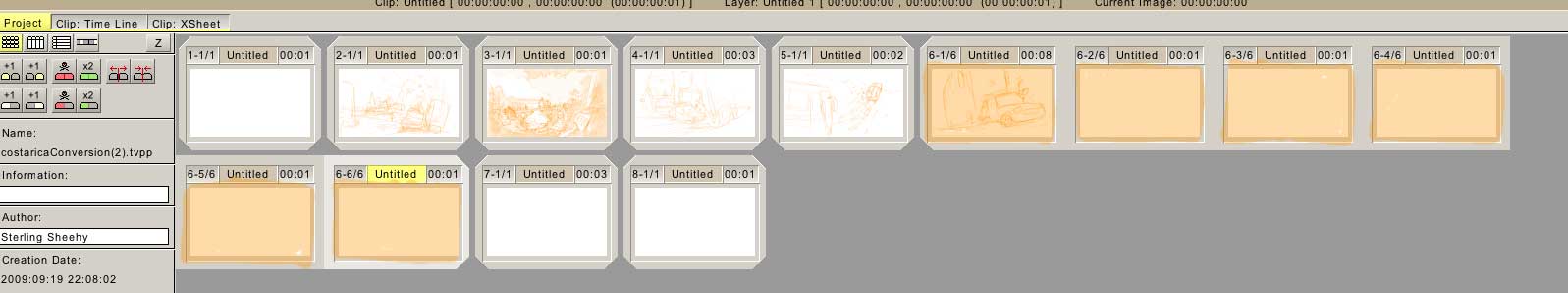

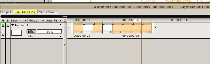

example: I've highlighted frames in the scene window below that I would like to be treated as keyframes or "clips" ideally these should also be easy to move and swap around.
The project window shows only the frames selected in the scene window
A scene file with selected frames to be used as clips

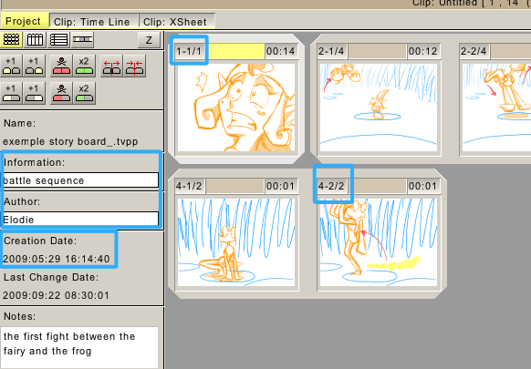

ammoniteboy wrote:4.)OK this is a big one! By default don't name everything Untitled, assign every frame/board/clip a unique serial number that follows it anywhere it goes. Its fine to add names and other tiles but for the most part this isn't as important as a serial number. Scripts change, scene numbers change, characters and event names change so titles are often pointless. The only thing that shouldn't change is the boards specific serial ID number. This way it can always be found. This is a common problem six months into a production. someone sees a piece of art pinned on the wall and no one knows who drew it or where to find it. Please, please please add serial numbers!! Ideally make them in a format that other programs like final cut pro can read as well, like xml. That way post production programs can read the board files.
Eer... there are scenes and clips serial on each clip. And that's also why we use an information panel on the right. Thanks to this panel, nobody hesitate about the author or the creation date. By the way, a serial number won't be useful : imagine there 3 storyboarders. Each storyboarder will create a storyboard with serial-numbered clip. At the end, you will have 3 clips, with the same serial number, but not with the same contain...
You have to write the serial number, such as "Sequence1_Scene_2_Plan3", not TVP =)
