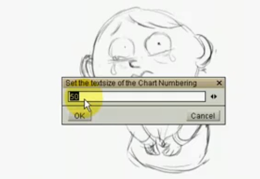

Here is a small problem I have with "Charts" (running TVP on Mac OS 10.5) --- when I 'Set Number Position' by clicking there is no box that pops up to allow the size of the numbers to be adjusted as you show in the video you posted on YouTube. Perhaps this is only a Mac bug ?
This option does not appear in the Mac version of Mads Juul Panel
Set Size of Number.jpg (28.15 KiB) Viewed 6101 times

D.T. Nethery wrote: Here is a small problem I have with "Charts" (running TVP on Mac OS 10.5) --- when I 'Set Number Position' by clicking there is no box that pops up to allow the size of the numbers to be adjusted as you show in the video you posted on YouTube. Perhaps this is only a Mac bug ?
have you installed the latest version? I found some bugs in the chart part when testing and did the size solution. so its first after vesion 1.04 that the box appears. do you have installed version 1.06?

AH ! Thank you, Mads. That did the trick. I had 1.03 installed from earlier, but had not installed 1.06 . It works perfectly with version 1.06.
