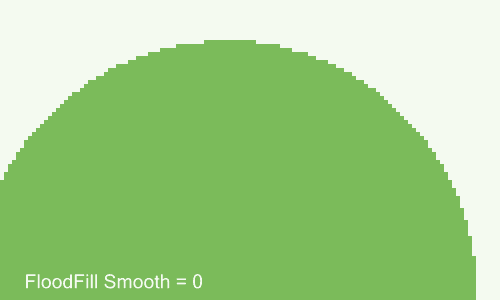

I guess so,
although I have noticed the FloodFill Smooth parameter tend to extend the filled area,
so you could have to balance this growing by tweaking Expand to a negative value (-1).
the other confusing thing (to be fixed imo) is that Smooth = 1 (which should be the AA equivalent)
doesn't smooth anything (see Gif below, Zoom x4), the smoothing effect starts only at Smooth = 2.
anyway, with a little care in your settings, you should get exactly what you need.
also, to get rid of AA artifacts with the floodfill tool, don't miss the "Behind" mode,
with a bit of positive Expand (+1 or +2) to overlap the line art.

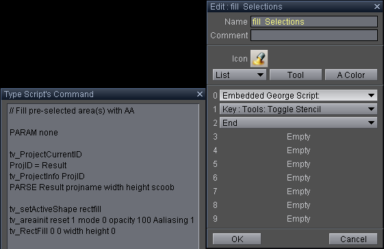

Is there such a function so I can make multiple magic wand selection and then fill with a color?
That would be nice. in PS I can have a multiple selection and either erase it with delete or fill it with the foreground colour with alt-delete.
Re: bucket anti-aliasing option
madsjuul wrote:... or what should the option be to precisely recreate the antialising effect with the smooth option?
not exactly, but roughly AA equivalent is : Expand = -1 and Smooth = 3 .
madsjuul wrote:... Is there such a function so I can make multiple magic wand selection and then fill with a color?
it's the way I often use, multi selections first (with AA), then a shortkey to fill all-in-once !
