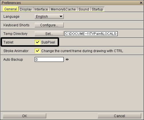

Incidentally, your lines jitter because you probably have subPixel unchecked in Preferences.

Hi CoreyAnimator,
If you are on PC, you should really activate the Sub-pixel function :
If you are on Mac, don't look at this feature, Sub-pixel is automatically activated.
TVP Animation is the only one to use Subpixel: it means you can draw with smooth lines, even if your view is about 10%.
Not yet, but you've been heard by the dev team
CoreyAnimator wrote:The cintiq is great but still I do wish there was a feature that could autosmooth the stroke a bit while you draw?

Not sure if the jitter is caused by the subpixel thing Paul & Elodie?
As CoreyA said, its only when drawing on a zoomed out project. So I suspect the jitter is simply caused by reaching the tablet's resolution... i didn't know subpixel could fix this?
a workaround for Corey could be to use the "m" (new zoom window) key and set one window in 100% view so you see the whole project and use another window to draw in where you zoom in on the detail you are at.
{edit}
confirmed, the subpixel option does the trick.
when i tried to repeat what i did in the attached QT the lines were completely bumpless and happily smooth, we could maybe call this(drawing at below 100%zoom with subpixel on) TVP's smooth feature!
