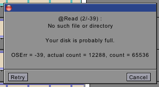

i've also gotten these error msgs with other files that look like this; they occur while trying to save; the msg remains for a while regardless of whether i select 'retry' or 'cancel'; after multiple clicks the msg closes and the saving seems to finish ok:
any clues to what i'm dealing with here?

Hi,
Is your "My Book" a NAS or a USB drive ?
The read error looks like an intermitent failure to read from the drive.
This can come either from an error on the drive, or some network problem.
This also most likely caused your file to become corrupted, because TVPAP writes to a file ONLY when explicitly told to save or export.
We added checks to v9.5 to not crash with this kind of corrupted file, but display an error message, and try continue loading what it can.

i have to admit i had to look up 'NAS' to learn that it is 'network attached storage' but i don't understand much more than that about it; sorry. the 'my book' drive uses firewire as apposed to usb connectors if that's part of your question. i could attach the rest of that crash log just in case you're curious (i guess i would need to attach to a PM). do you suspect the problem could lie with the drive? it's partitioned to 'mac os extended (journaled)', btw, which i guess is the same as the recommended 'hfs'.
