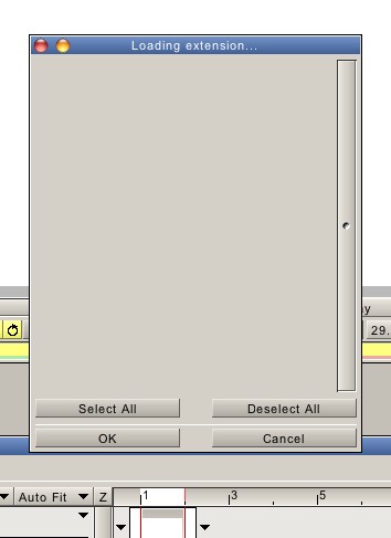

When I try to drag and drop the tvpx file onto Tv Paint it install I find some have a check box while others do not (see attachment). Sof far I've had this result with Chinese_Brushes.tvpx and opaque.tvpx
screen capture of empty tvpx

At least for Chinese Brushes, there are two versions.
The one with chinese file names doesn't load on western OSes.
Look in the same thread you found the one you have if you have the right one, the one with western file names.

Re: installing custom brushes
it sounds strange. TVPX should work on 8.6.2.
I've just tried to read the Splatter brush with TVP Animation 8.5 Standard and you are right : there is a problem when reading the TVPx.
Hmm...
We've tried different things (withdraw the "!" in the name, export the panel in .bin)... but it still doesn't work. We cannot anymore make launch TVP Animation 8 in debbug mode, so I will convert the brushes that interst you. It's the only thing I can do for you at the moment =)
