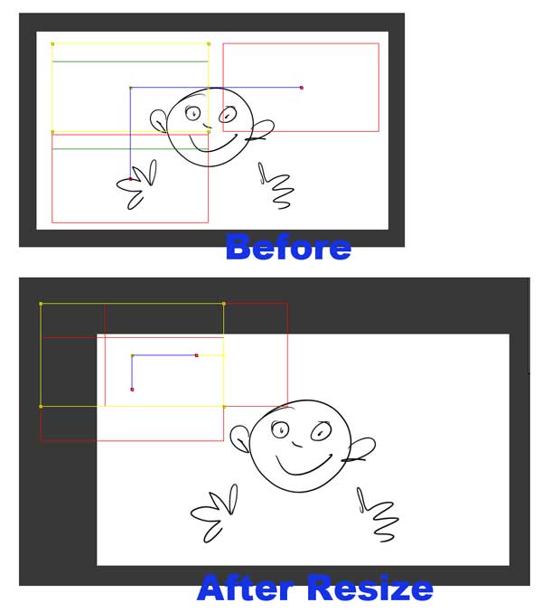

Here is a picture showing the project in 1920 (before) and 6000 (after). I think it demonstrates the problem very well. I have a workaround for that problem (make kind of layout-level to have "markers" to reproduce the cam movement), but I would prefer not to place the cam a second time.

- I can change the parametres of the cam and it changes every cam-frame - but not the path.
- The cams width and height is changing automatically (scale) after resize, but not the path.

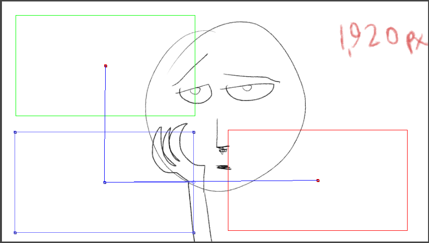

I recreated the situation here, and upscaled 1920 to 6000, and my camera translated well, including the path.
see images (the 6000px is smaller here only because I zoomed out when I captured the screen):
- May 30 22-46-41.png (46.8 KiB) Viewed 23569 times
- May 30 22-46-21.png (56.92 KiB) Viewed 23569 times
