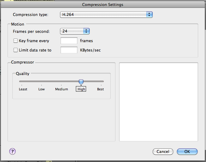

and for some reasons the Quicktime movie won't open ? That's peculiar. What export settings are you using ?
Try these compression settings for preview render to Quicktime: H.264 , 24 FPS (uncheck the box that says "Key Frame Every ____ frames" ) "high" or "best" quality . Open in QT Player or VLC to view.
QT Export Settings.png (47.56 KiB) Viewed 6511 times
