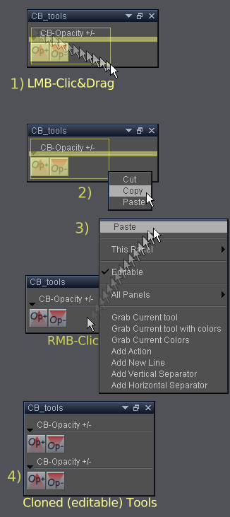

Re: Way to make TVP behave like Photoshop?
also you can "Duplicate" the toolbar and Rename this new copy (+ close/hide the original) before tweaking the tools to fit your own need,
so you can at any times go back to the original by re-launching the first one.
alternatively, instead of duplicating the whole toolbar, you can select/copy/paste any button (tool) or block of buttons (see pict.),
and that inside the same toolbar, or from one to another, then, edit/rename the new cloned button(s).
