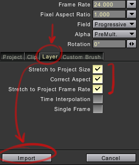

It sounds like in the Import Footage you are bringing the scans in as a Project instead of bringing them in as a Layer of the existing project.
Make sure that you have the Import Footage set to Layer.
