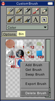

I'm a newbie - I bought TVPaint last night - and I'm on an iMac i7 running OS 10.6.8. I can't figure out how to delete custom brushes that I saved to the brush bin. In the manual there are instruction to right-click on the brush and that will bring up some brush option including "delete brush", but if I control-click on the brush nothing comes up. What is right-click on the Mac? and is left-click just a regular mouse click ? (I've got a USB Mac mouse.)

Since you have the Mac mouse try this: hover the mouse cursor over the brush you want to delete , then hold down the space bar on the keyboard and click on the brush with your Mac mouse (while still holding down space bar) . That should bring up the tool bar menu with options to "Delete Action" .
Or when deleting from the Custom Brush "bin" , hover the mouse cursor over the brush in the bin you want to delete , holding down the space bar while you click on the brush with your Mac mouse. That will bring up menu with option to "Delete Brush".
