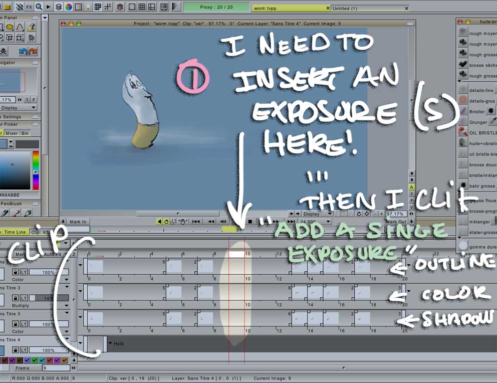

When I'm working on several layers, such as : a black outline layer, a color layer, a shadow layer etc…

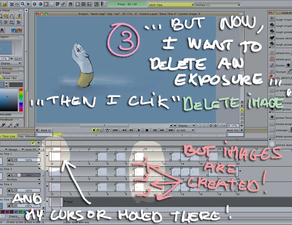

… if I configure a key with "delete image"* in order to remove an exposure in the clip (on all the layers)… TVP deletes the exposure (cool) but makes also a copy of the "head-images" on this same location… and it's not what I'm expecting…
… my wish is just to remove the Exposure on all the layers, not to get this copies … that I'm always obliged to put back in place .

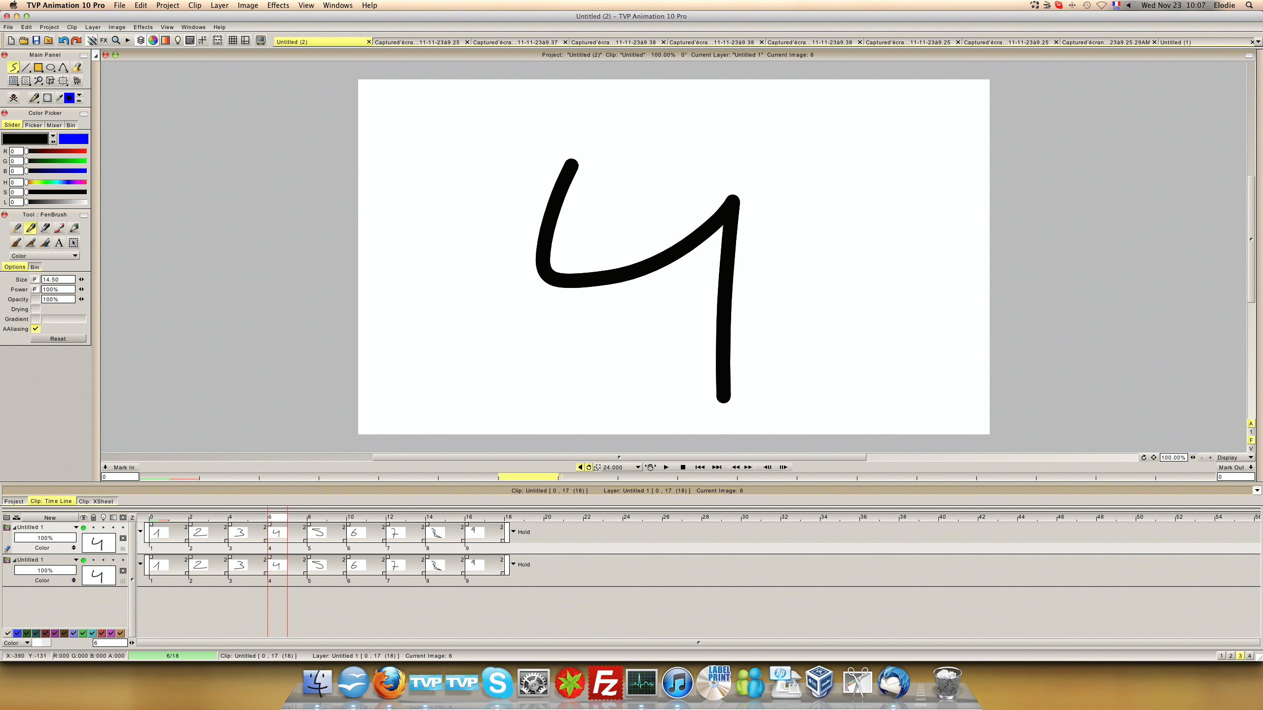

Re: "delete single exposure" option ?
chatbraque wrote:… is this option available on the new version (.10) ?
Yes =)

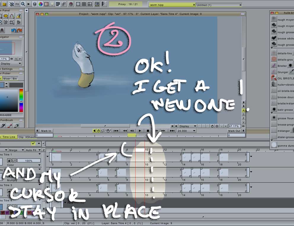

let's have a look at the feature : "project : Clip : Add single exposure"
… when you use it in on a multi layered project - by positioning your cursor in the timeline at a place where no head instances are situated underneath - it's able to add an exposure on all the layers… without adding a head instance…
I need to do the same when deleting an exposure - on all the layers at once, by placing my cursor above in the timeline on a spot with no "head instances" underneath… … AND not getting head instances in return on all the layers under this spot…
like it's the case when using "delete image" …
(otherwise you're obliged to delete them one by one on each layers)

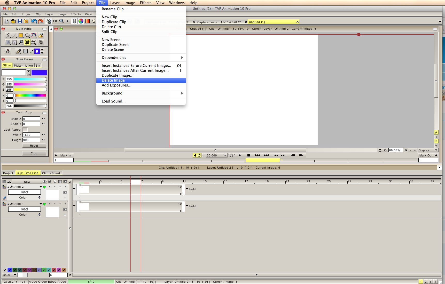

Chatbraque...
If I tell you "this is in TVPaint 10", it means "this is in TVPaint 10" =)
Yes, the feature is still name "Delete image", because it's true. "Delete image" is in the "Clip menu" > it deletes the current image, on all the clip.
Click to see the animation
