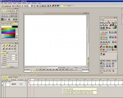

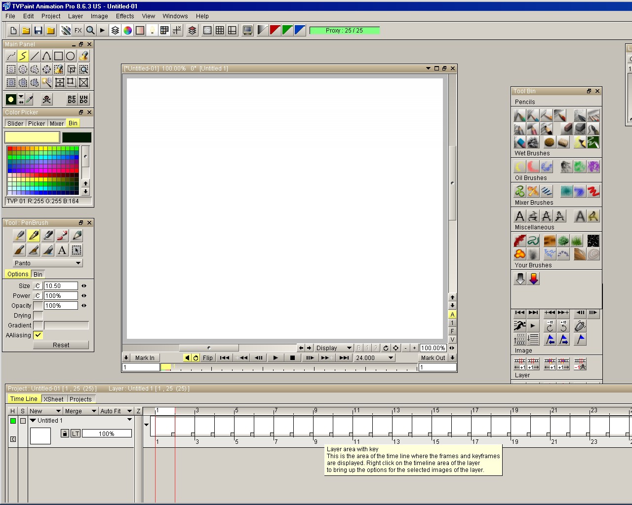

Re: Can I Get My Old TVP Pro 8.5 Back?
Thanks for responding so quickly to my post.
I have installed TVP 8.6.4 Pro.
It will open. I can paint a single frame with it.
When ever I try to add 25 or more anim frames, the proxy window will only fill with 9 or 10 frames. Then it will take about 45 seconds or a minute to
fill with the remaining frames. After that, I can start animating.

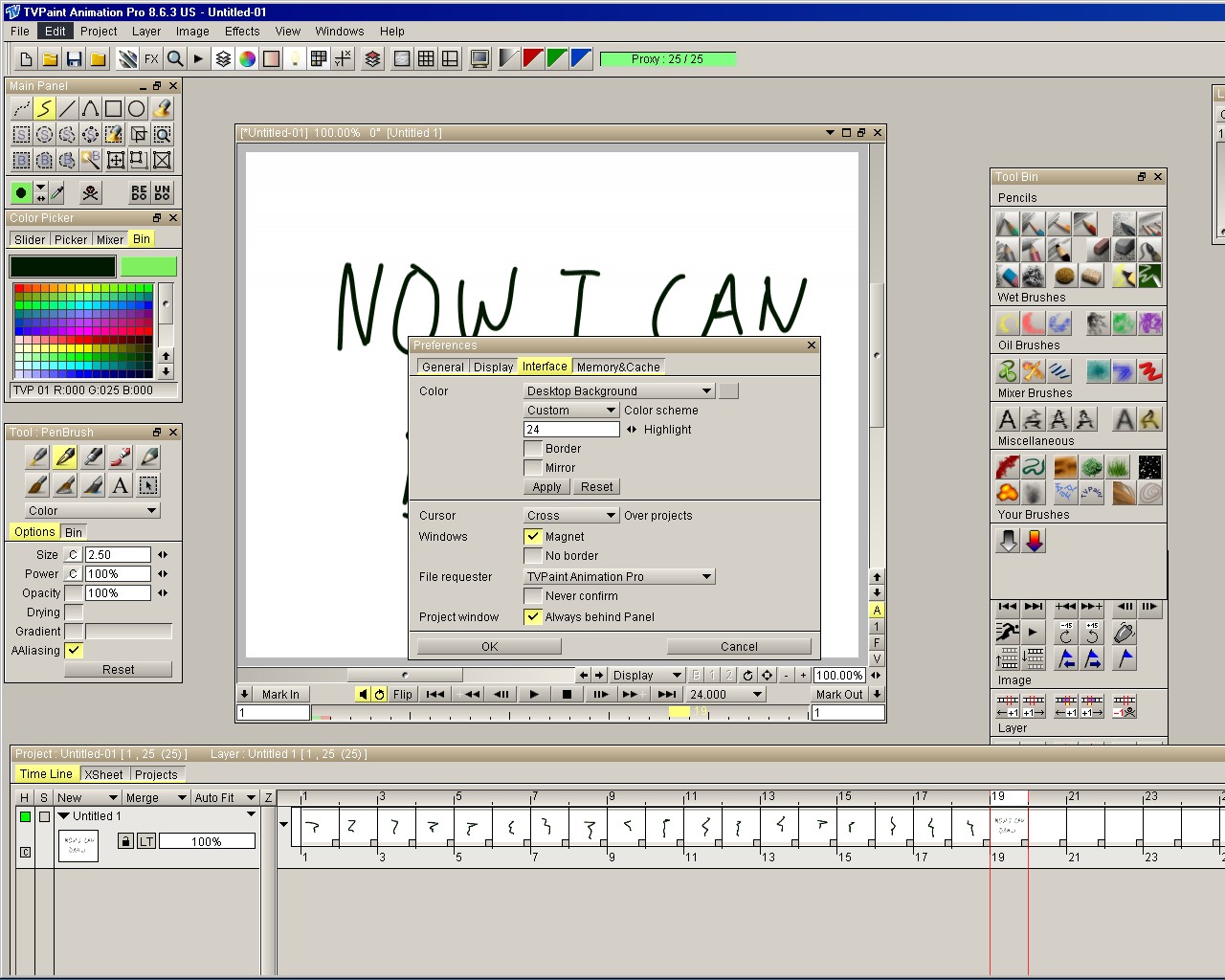

can you upload screenshots ?
I don't understand how can you obtain only 9 instances if you ask for 25.

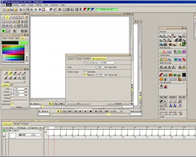

we also need to know your preferences settings regarding the memory use.
[img[/img]
- Attachments
Here are my preferences...

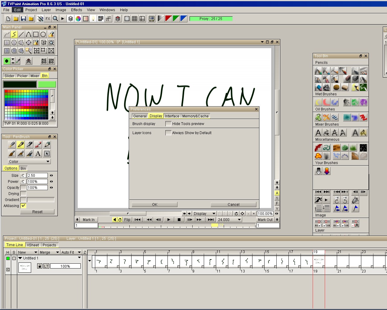

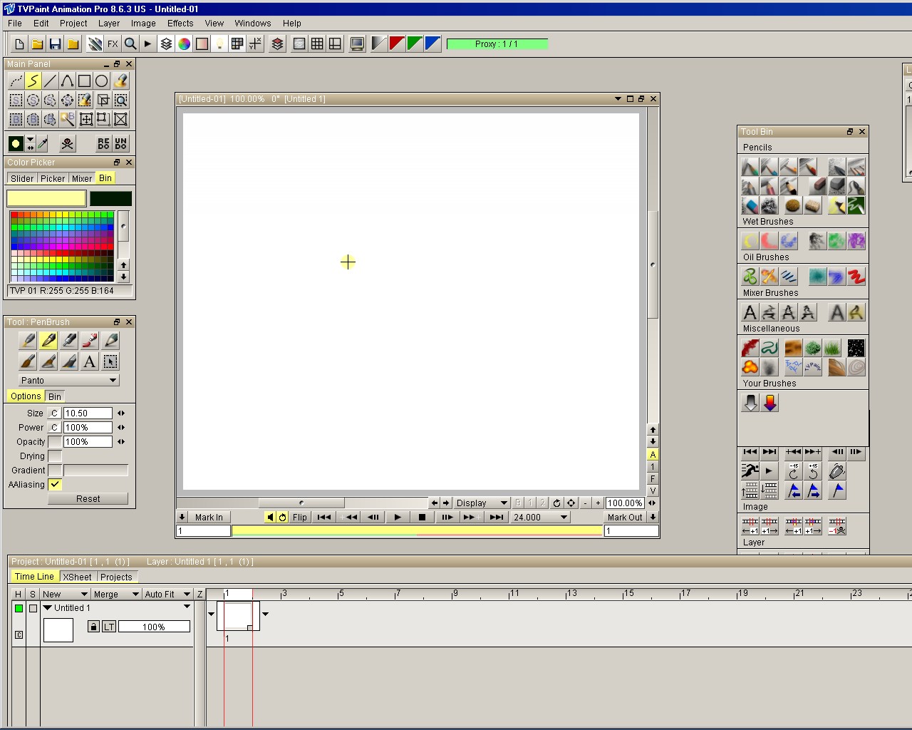

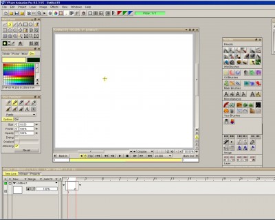

Chris, you are able to draw, even if the proxy is calculating...
But if you don't want any proxy :Windows > Display settings > and disable the proxy.
No, I am not able to draw when the proxy is calculating. TVP locks up.
But I did windows>display and disabled the proxy. Now it is working.
Thanks!
Thanks!
