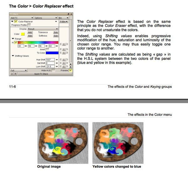

Color Replacer FX is yet another of TVPaint's powerful, yet somewhat "hidden" features for digital ink & paint (like the Auto-Pick Color option)
It is not immediately obvious from the User Manual how the Color Replacer FX applies to cartoon figures.
I'd think this should be replaced by illustration using an animation figure (the "Running Kid" perhaps) so it is easy for new users to see at a glance how it applies to coloring animation layers.
